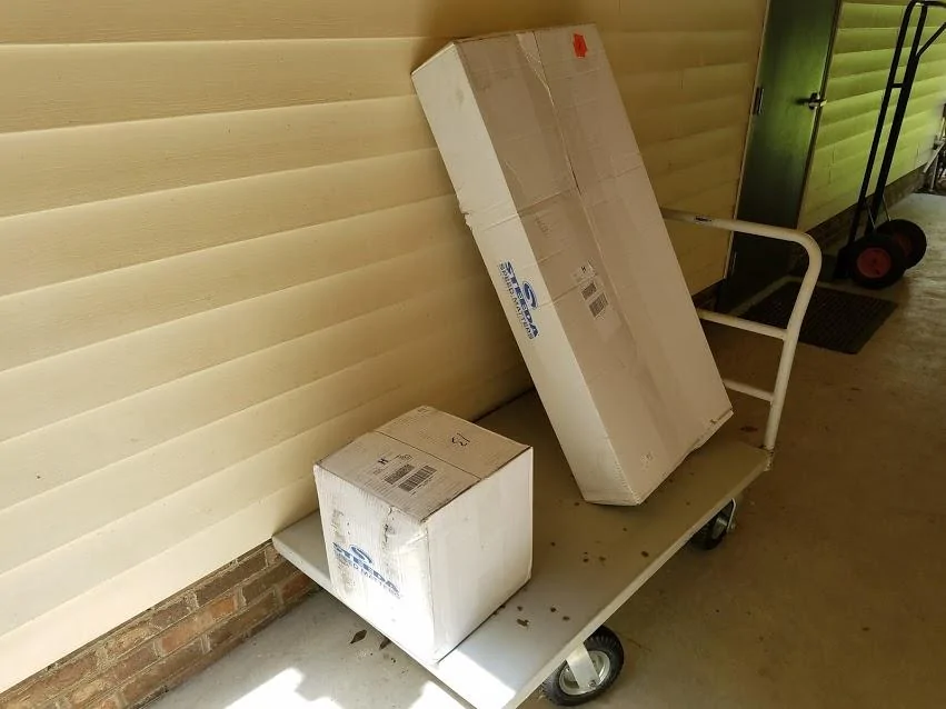

[MENTION=16585]Warhead[/MENTION] your post #4 in this thread reminded me I have a problem. I have this mountain of Steeda boxes that pile up. Certainly not even close to all of them but some of the recent ones. My wife says I'm a Steeda box horder and Steeda is probably having a box shortage... :headbonk:

I have the same problem, lucky for me I own a warehouse and dedicated some shelf space to every single factory item removed and every single box per mod ever received!
I figure if I sell her on some day, would be nice to have around. :)
