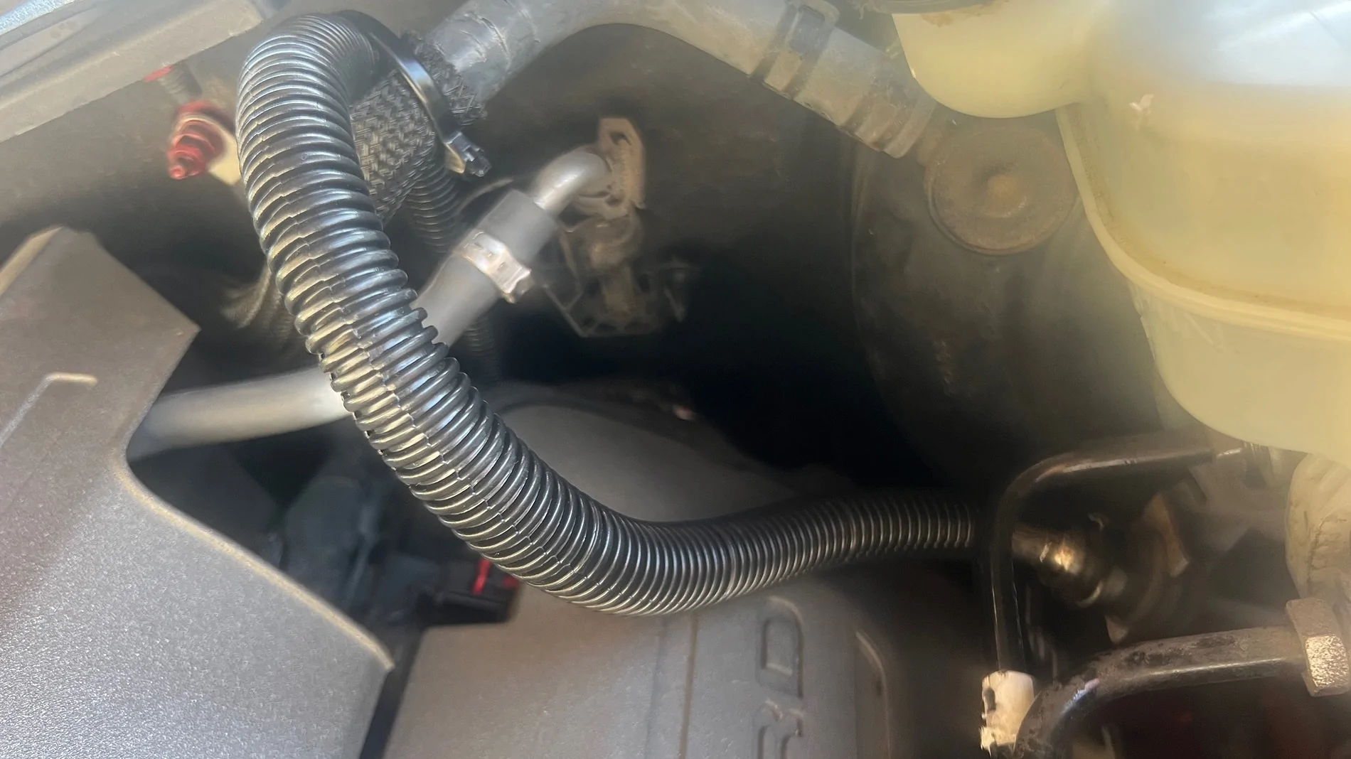

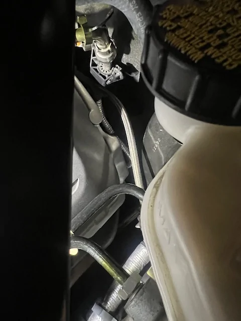

I installed the Steeda SS clutch line and have a quick question
All went well but the line seems to be just about 8 inches too long causing a high spot near the reservoir, not enough to interfere with the hood closure but higher than the stock line.
I ran the line as recommended so there aren't any hard turns, loops or stress on the connections.
Anyone experience this as well ?

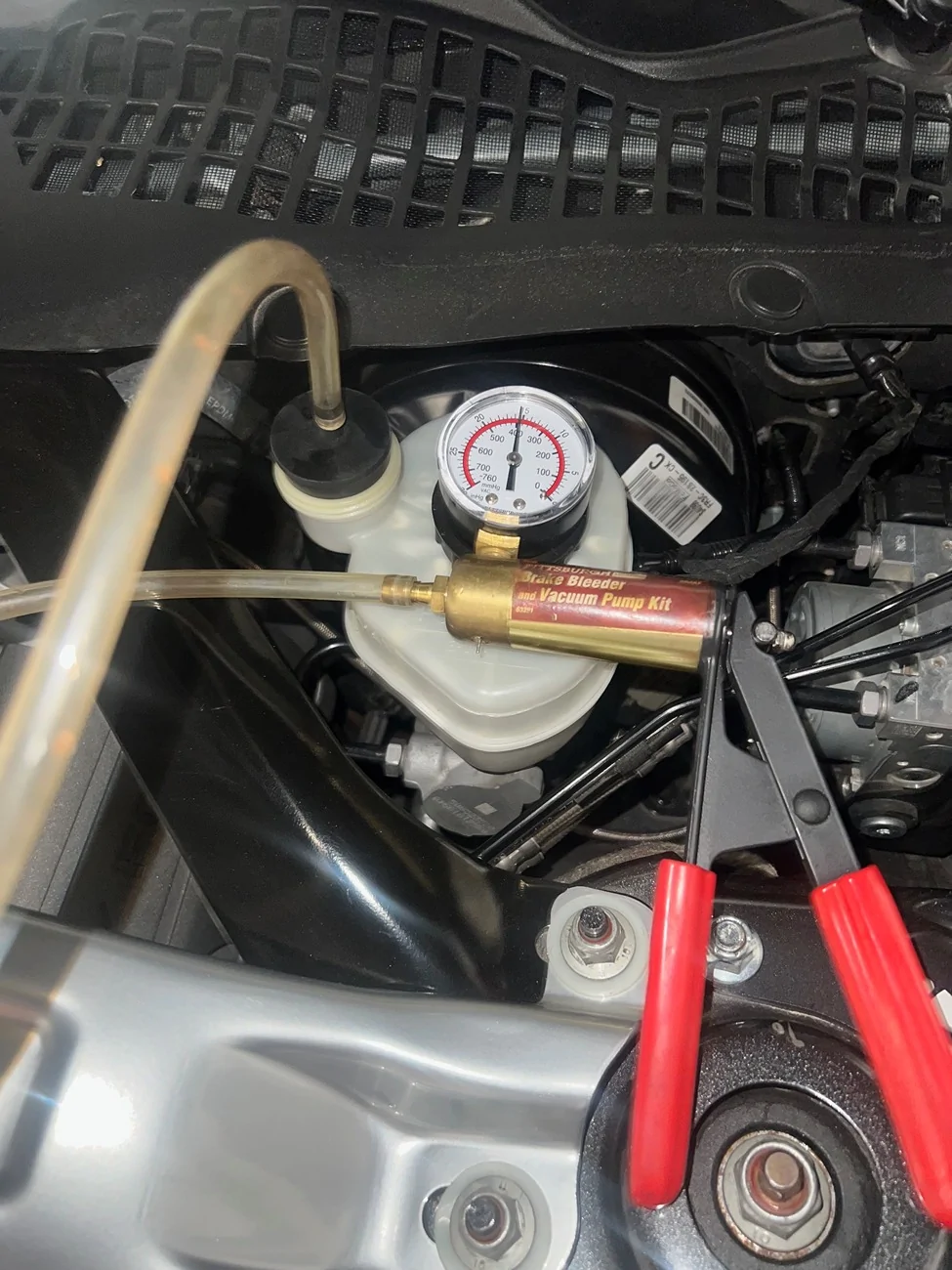

I have installed a SS clutch line and this did the trick. Pull a vacuum on the reservoir this should help pull the rest of any air out of the system.

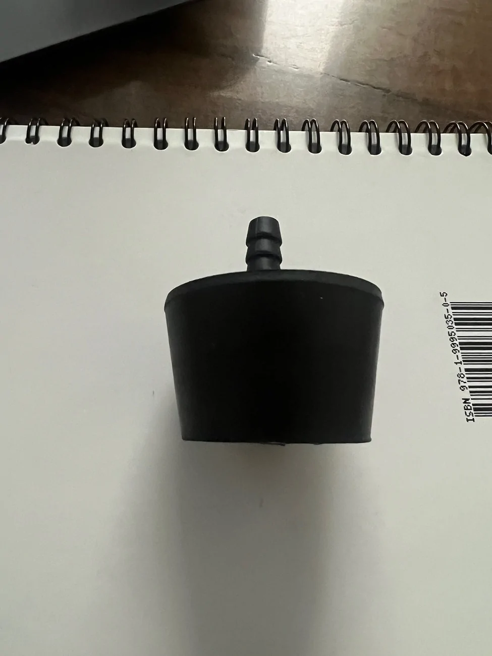

Nice, I have a bleeder kit but need the rubber stopper- what size did you use ?

1.1/4 tapered I picked it up at Ace hardware then drilled a hole and pushed a vacuum line coupler through.

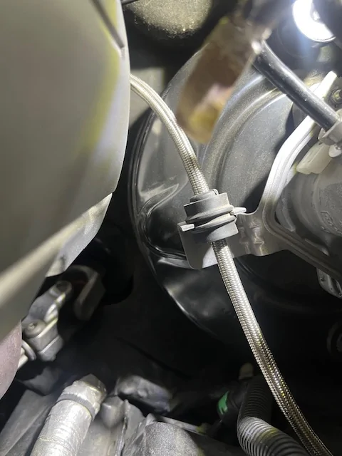

Rubybarchetta
Not sure how you routed your SS line, here's how I did mine.

I see now- I connected at the metal bracket leaving the existing metal line from the firewall to the bracket
Looks like you eliminated the metal line and connected the flex directly to the firewall connection.
I did not realize it could be done both ways.
I looked at the firewall connection and it looks a bit different from the bracket
connection.
Note that I put a flex sleeve over mine

Ok, Idiot alert !!! I see where I messed up.
I re-routed and connected to the firewall connection. It's all good now
Thank you MyStang for the info !

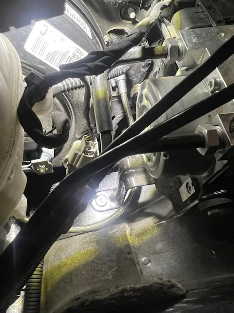

I recommend getting some 14" angled nose long nosed players for attaching the connector at the transmission, I used an 11" and it was still very difficult because room is extremely limited.
Also- be sure to connect the upper connector to the actual firewall connection not the extension connection. See pics above for
reference.
Use a set of picks to pull the clips out enough to remove existing connectors.
and push clips back into place before connecting the hose so you feel a positive click when properly seated.
Be patient when bleeding, I had to pump about 300 times to get a good feel of the pedal.
