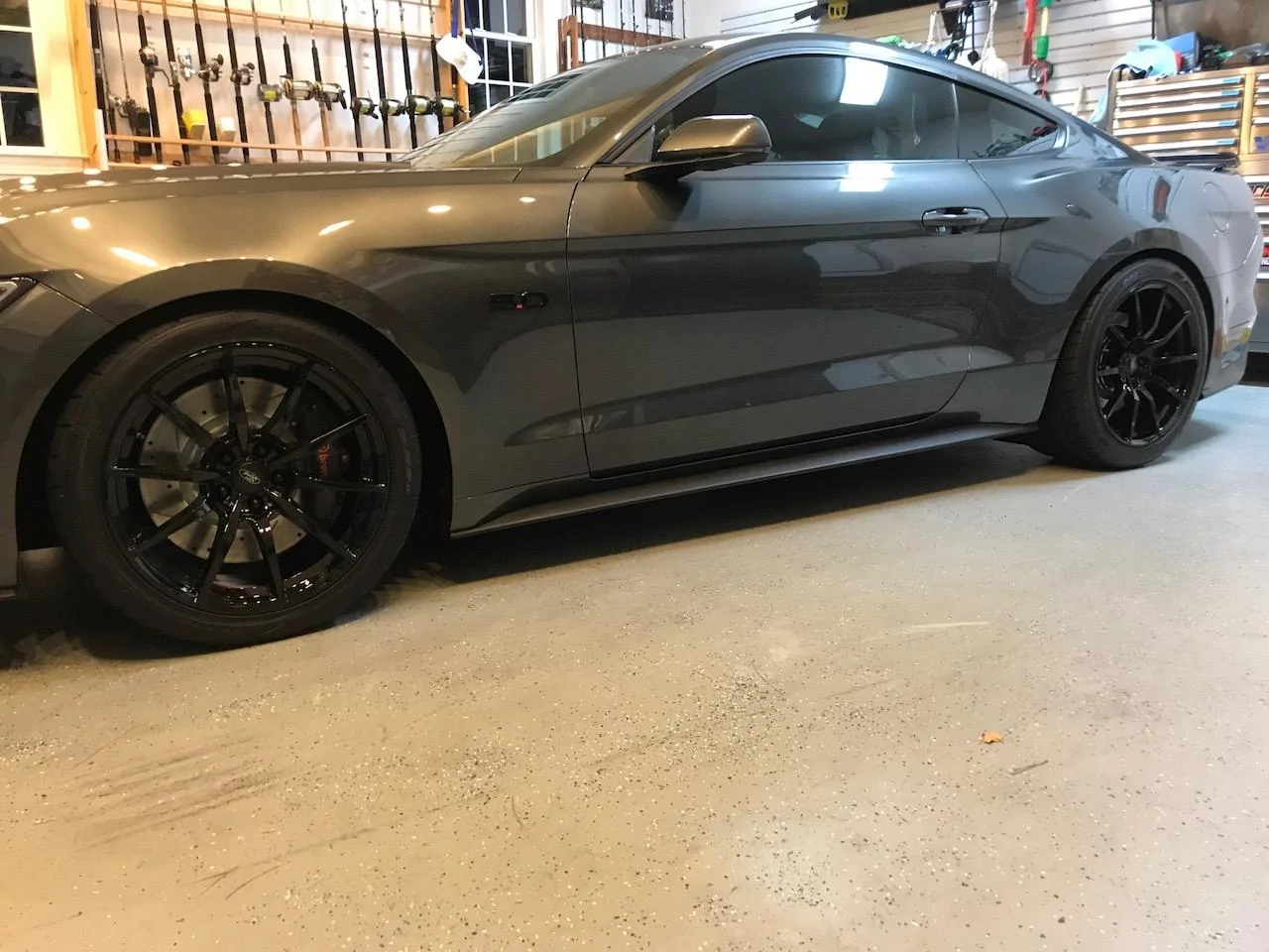

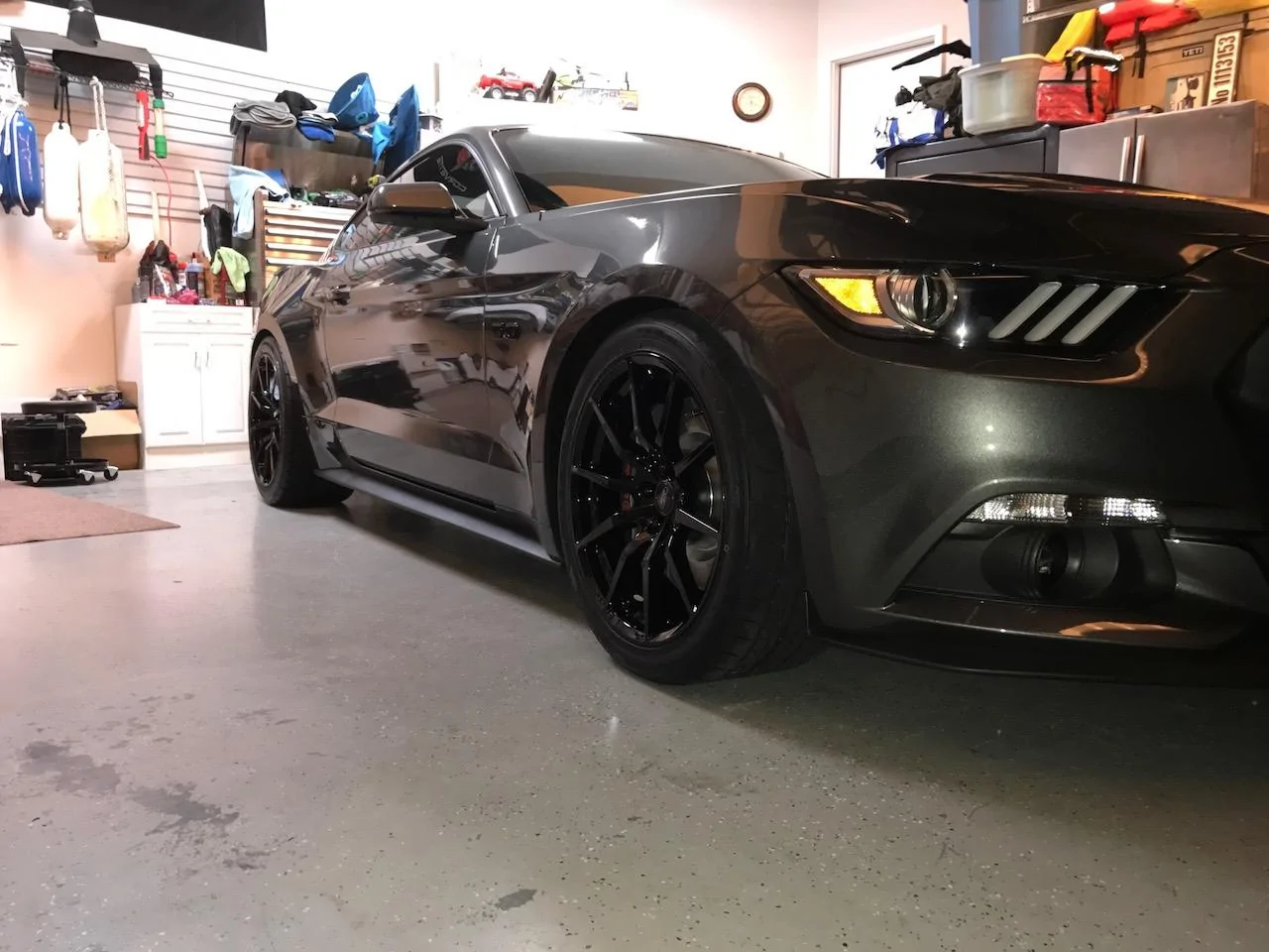

Got everything installed today. Honestly it was a pretty straightforward installation. The most difficult part of the installation was knocking the spline studs out of the front struts and removing the rear springs after dropping the IRS sub frame. Thankfully a 4 LB hammer encouraged the studs to come out and my next door neighbor came over and helped with pushing down the suspension in the rear so I could pop out the springs.
Sadly I didn't get to take it around the block. By the time I finished it was pouring down rain and storming. Anyway, the setup consist of Steeda Progressive Sport Springs, Steeda Pro Action Struts and Shocks, and Steeda Camber plates. The Steeda rear shock mounts were on back order and will get installed later when they come in. The car also has the Steeda G Trac brace, IRS alignment kit, IRS bushing supports, and IRS Sub Frame Support Braces. I've got to schedule an alignment as I can tell the toe is out. The Steeda Camber plates are sweet. Should make dialing in the front a piece of cake. Hopefully the back won't be a problem but I can address it if necessary.
Now a couple of photos. Sorry I'm in the garage and photos are with an I Phone. Would love to get some in better lighting.

We'll let you slide on the photos, lol, what a heck of a garage!
