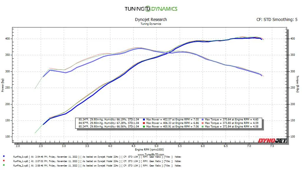

Hey folks,
I have a 22GT Premium PP1, so far the mods are:
Steeda CAI intake
H Pipe
I loaded the E85 tune I ordered from Steeda and these are the Dyno results from Tuning Dynamics in New Port Richey
I don't believe I am where I should be WHP and WTQ wise.
The pulls were done in 4th gear.
I've reached out to Steeda and sent a datalog, waiting for a response on their end.
I believe it should be closer to 450WHP.
Any advise is welcome.

That seems very low for E85 tune. Did you drive around a good amount before loading the tune and dynoing the car? I know some tunes need to learn first or you will get a really low reading.

Your car peaked at 406DJs (dyno jets)
Stock your car was probably making around 370-380DJs.
Dynos are a tool to see change not for hard numbers.
