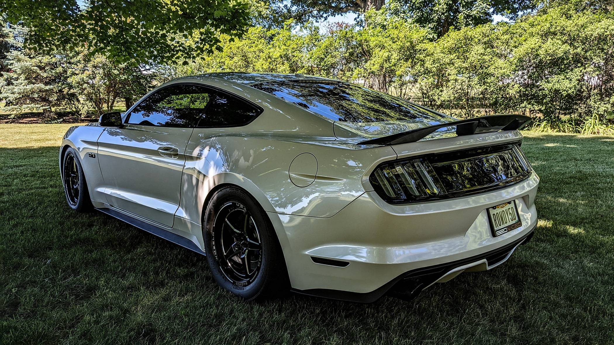

Thanks for the reply! Did they help with your time at all? Did it improve the 60 foot? Any photo how are you car sits from the side?
Great looking car!

It’s hard to say if the springs helped by themselves because I made multiple changes at 1 time. It definitely looks better then stock.

BMR sport lines with a 17Ă—10 VMS 305/45/17 and ive never rubbed. I will say my longtubes have scraped shit more than I care to admit though lol. But I am switching springs for more of a drag setup soon.

Based on the picture you have a lot of negative camber in rear though.. so I would say you probably
Would rub if you had neutral camber

What springs are you changing to? I am looking to increase my 60 foot and have the same wheel / tire size as you.
What is your camber at?
Nice looking car.

Thank you. I haven't decided on the spring/shocks yet. Probably a Viking/Steeda or a Viking/Eibach combo. Not sure on the camber. I've needed an alignment for a year now lol. I've had the suspension completely apart a couple times and I've been lazy getting the car on the rack.
