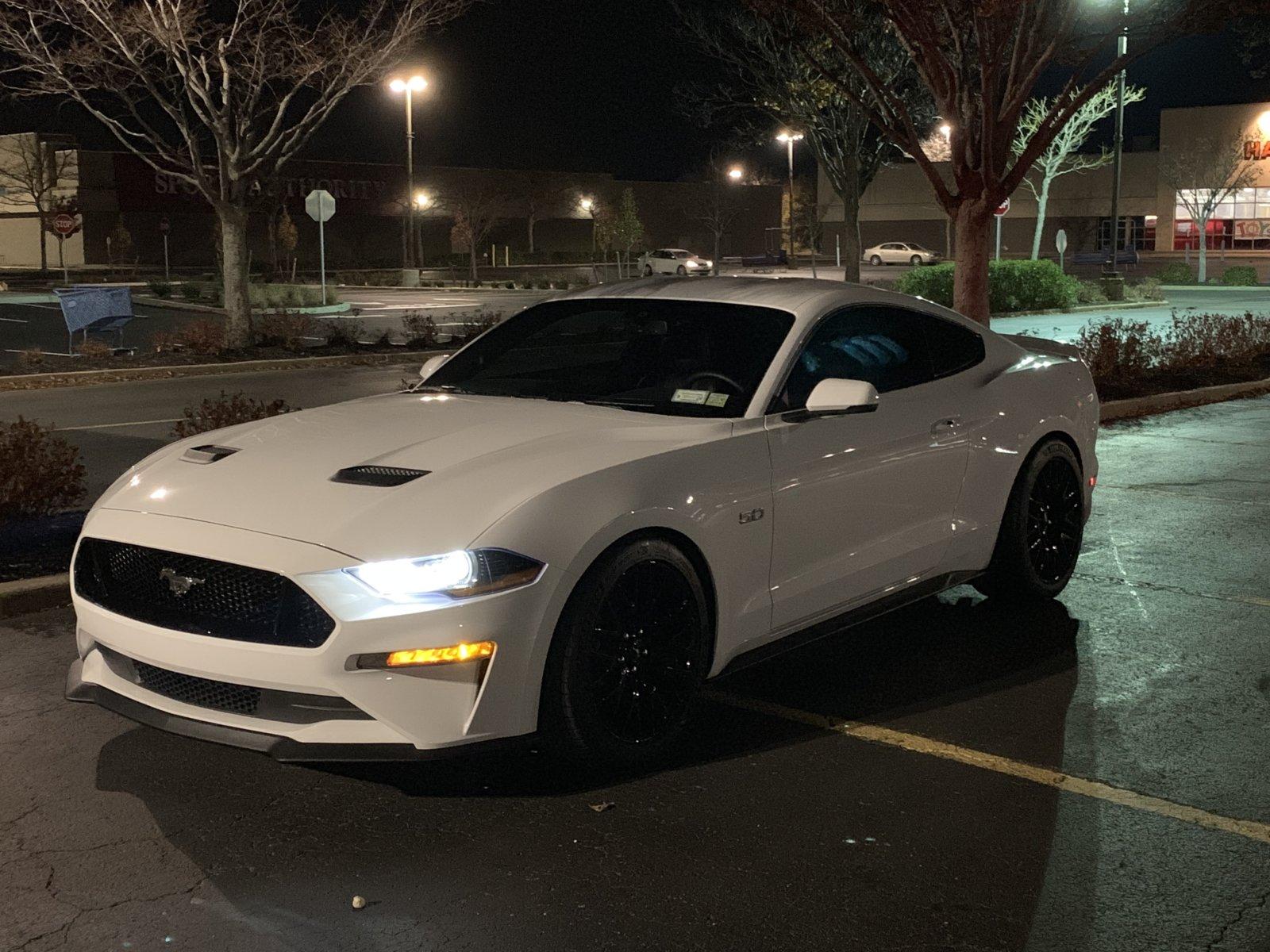

I replaced mine with ford performance X springs. These are the street springs. Lowers the car 1 inch all around. Gives a nice noticeable improvement in handling without a drastic change in ride quality. They are a little stiffer but are a progressive spring. This along with the 25mm spacers gives a great stance with the pp1 wheels.

I honestly don’t remember the brand. They are hubcentric. I torqued them to spec and then checked them again. No issues or vibration at all. Very happy with the ride and stance.
