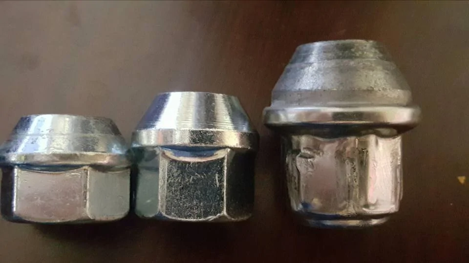

Even using the short lugs as shown in your picture several posts back. Looks like you could get an extra several mm of lug travel and turns with those lugs. Could you squeeze 10mm spacers on with those lugs?

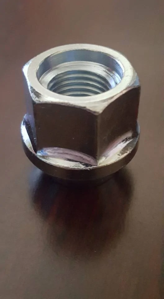

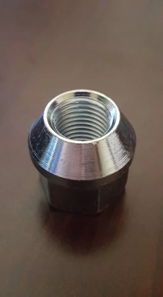

I may have not expressed my point clearly with using a lug nut with more thread engagement. It would only help if you have suitable stud length. I have attached two pictures. The nut with the yellow paint mark is an OEM lug nut with the beauty cover removed. You can see that on the factory hub with no spacer the stud only slightly protrudes beyond the threaded portion of the nut. The other nut is a fully threaded nut that the stud does not protrude from and in fact is only utilizing 1/2 of the thread.
