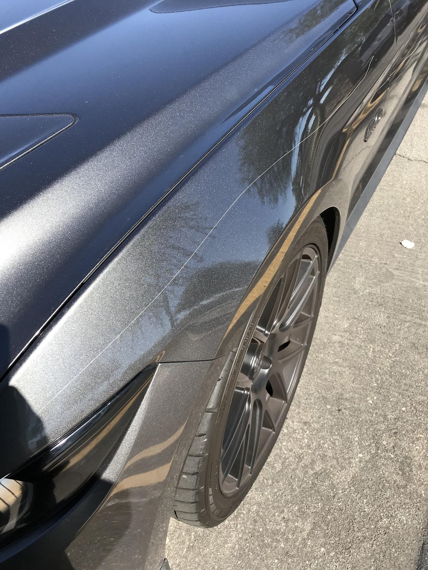

Feels deep. HATE people for doing this.
Repaint?

Man that sucks........If it's deep it will be a repaint.

Wet it down, if it disappears its not throught the clear it can be sanded out but of course some clear will be removed to do so.

Thanks guys. Looks to be deep in the paint. Sucks..
Gotta keep in mind though that the clear coat can fail even if you don't blow through all of it

Take some 2000 and sand that scratch down. Lay some clear in it you can get from any auto parts store.
Then blend with 2000, 3000, 5000, and then buff with paint correcting polish. You can make that disappear.
Don't get to aggressive with the 2000 and you will be fine.
