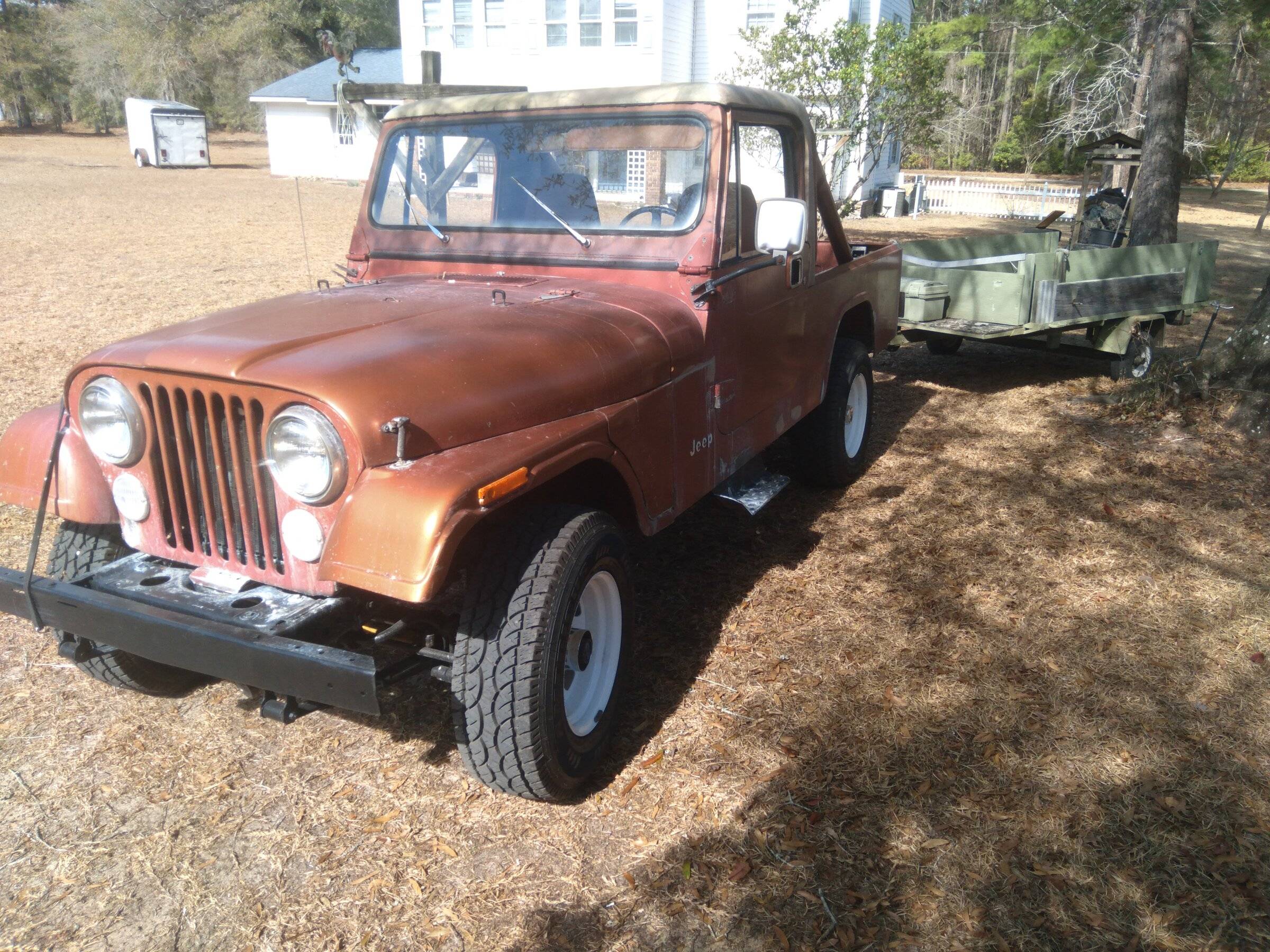

Converting my Scrambler 4 cylinder 4 speed to a 350 sbc carburated with a 700R4 transmission. Tires will be small 29"
I have read a lot of builds on net but have a question.
Will a 383 stroked 350 use more fuel than a 350 if both motors are identical?
This motor will be stock and built more for torque since it is a Jeep. Not a go fast vehicle.
Trying to build with MPG in mind. I am stuck on being carburetor, not fuel injected.
