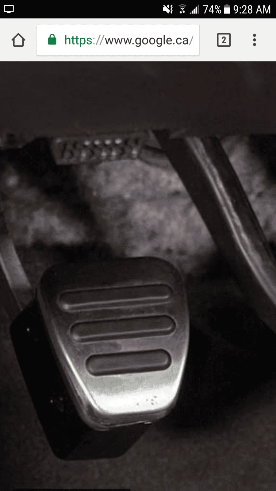

I went the cheap route and am manual here, so no button.
HP Tuners.
Engine > Fuel > Cutoff/DFCO
- Neutral Cutoff - 4500 rpm
- Neutral Exit Speed - 0.5mph - 1mph (depending on tire size)
- RPM Limit ETC Hyst - 300-400rpm (depends on what a person wants. I like 400rpm)
Edit - If I was auto, I'd put my transbrake button somewhere easy within reach and hide it as best I can. (Under e-brake handle, side of floor console near driver seat, Driver door in the underside portion of the window switch unit)

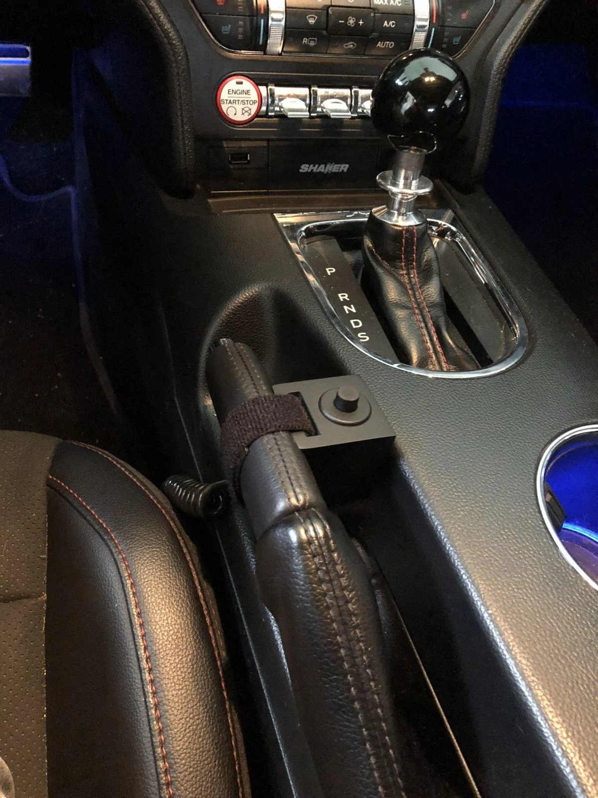

This is what I came up with. 3D printed button holder. Removes in seconds with nothing permanent! 2 step made a huge difference in launch consistency, and picked up a couple hundredths on the 60’.

There's a little removable panel directly to the right and below the steering wheel (kinda against the knee pad of the center stack). It's large enough to mount a button on, and is cheap/easy enough to get a replacement panel if needed.
