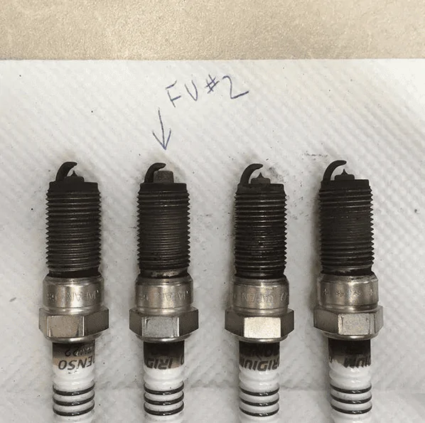

So I had a cracked insulator on my #2. What a relief. Still going to swap that sensor when it arrives though.

I know. these had about 20k on them

Have you been running octane booster or similar on those plugs?
I was recently. The misfire was annoying the shit out of me, so I tried that, and a tank of 104.
the plugs looked worse in the pic, it was only the threads that looked black. the insulators and electrodes looked golden brown.
