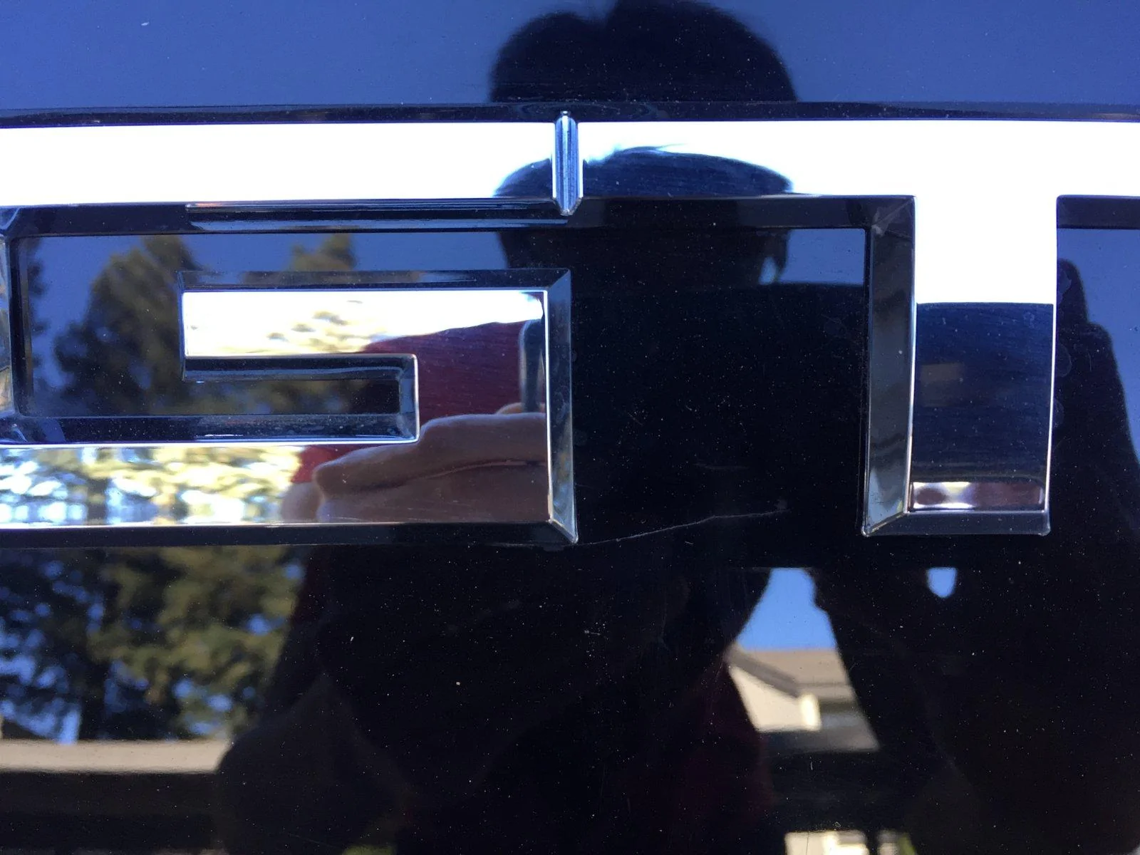

Hey guys, notice the quite deep scratch on the trunk cover.
Is this a plastic, or also part of the paint?
What's the best way to fix this, money wise?

The part is ABS plastic.
If the scratch is deep enough that your fingernail gets caught in it, it won’t buff out easily at all. There are specific polishes/compounds for ABS or plastic panels, but those are used for surface swirls or very light spider webbing type of scuffs.
Those panels are all over eBay if you need a replacement, far less than Dealer cost. Some folks have posted them here in the classifieds section too.

Great, thanks. That match my guess: not easy to fix/the cost of fix is much higher than simply replace it.
I am a noob in car world, let me ask another question.
Does the replacement has to be an OEM part? Or simply I shop around ebay and find a seller with good reputation?

Nothing ever has to be OEM, but you get what you pay for. Personally I buy OEM unless the other third party part manufacturer has a good reputation.

That part in excellent condition, being sold privately (not via Ford Dealer parts) is anywhere from $75-$100, excluding any shipping costs. There’s a few listed in the exterior classified section on here if you need one. Look for the keywords “decklid panel” as that is what most are calling that part.

That piece is a pain in the ass. I don't think that'll buff at all since it seems like it's past the outer plastic. Might just try cleaning it and going over it with a Sharpie pen or something. Or just try a few weird things before you spend money on a replacement. Nobody will likely notice it unless they're up close looking for it, especially with how dirty those panels get.

I just bought my new Mustang GT 3 weeks ago. I noticed my decklid panel had a crack in it right about the "T", I took it back and they replaced it on Thursday after the new part had came in.
