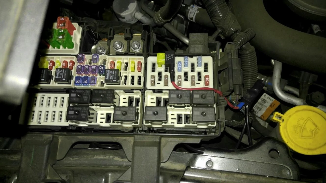

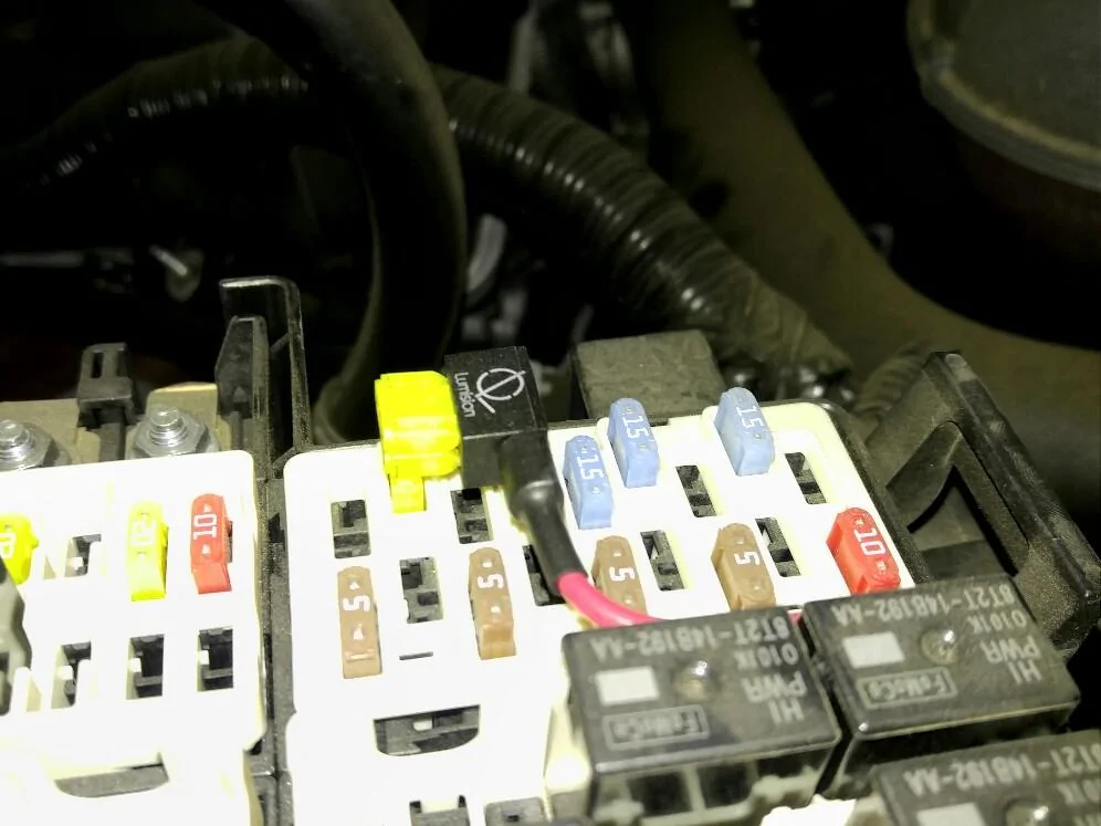

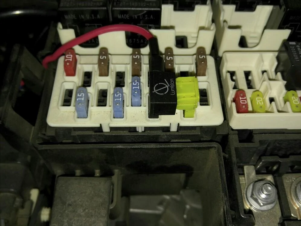

Mine are fuse tapped with a proper two fuse tap.
They're on as soon as accessories power is on.

would you name the component in the fuse box to link it to wire it to? im still a bit confused on what you mean. I think i found the part you were talking about, do you mean i should just wire to a certain fuse in the fuse box?

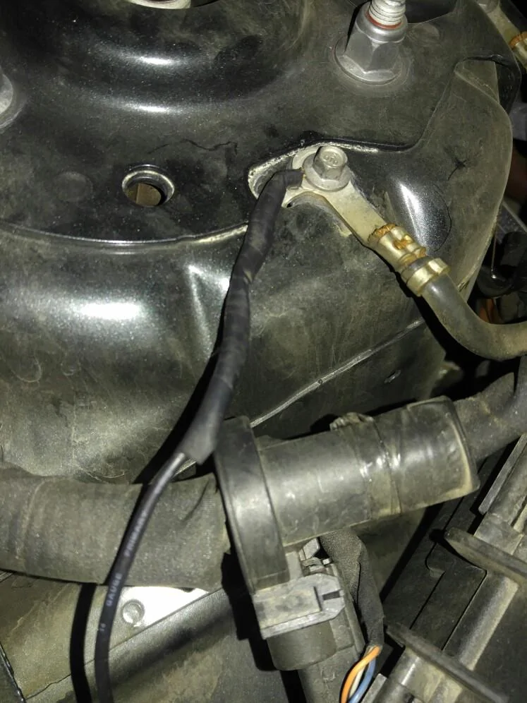

Yeah I'll grab a picture tomorrow. Basically I wired the positive to the fuse tap and used a 20amp fuse, then I grounded the negative to where the battery grounds on the strut.
I've had mine since February and my car is a DD, 15k miles lighting up and still great.
