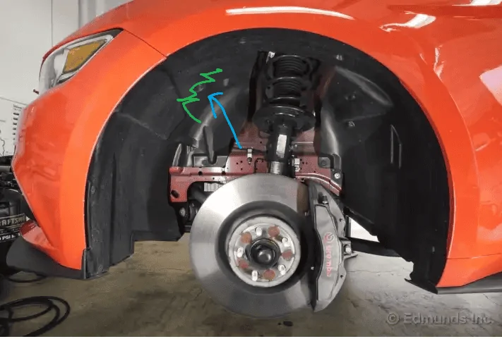

Hi, I'm using Roush 20" wheels and without the steering stop kit they are rubbing the body when turning. What if I drop the car by at least 0.8" when using the Roush coilovers. Won't it make the tires rubbing even more and additionally limit the turning angles? Are there any 20" wheels with Roush coilovers users to share your thoughts?

Rubbing the body or rubbing the inner wheel liner? All about proper offset and sizing. IIRC the Roush wheels are tucked in there similar to stock wheels, aren't they?
