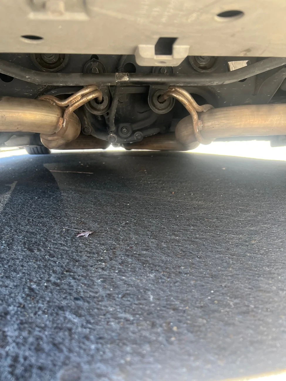

Can some of you show me your roush exhaust from the rear end, specifically the hangers that mount right around the diff.
been to two different exhaust shops for some rattling after a bunch job, the first fixed the noise temporarily then it came back, turns out they left a pipe unclamped.
fast forward to today another shop who found that, thought the fixed it, and it's much better but I am now getting a small rattle when driving and I think it's from vibration as it looks like those hangers are touching my sway bar and I want to see how much clearence everyone else has.
Picture attached.

I will crawl under mine as soon as the garage cools down a little. But I already know the cause. I installed mine myself and noticed the per the mid pipe cut directions it made the mid pipe a little short. So when you slide the exhaust pipe over the mid pipe it causes the bend in the exhaust pipe to touch the rear sub frame. if they didnt weld the seam and only installed it with clamps you can loosen the clams and pull the exhaust pipe and muffler toward the rear of the car. You should be able to pull it forward enough to get it off the subframe.
