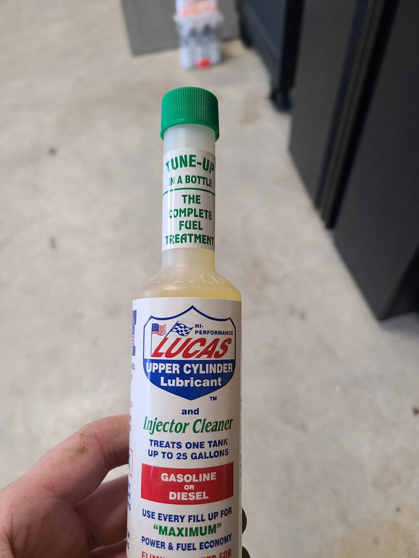

P-0300 is a random misfire, check your plugs if the code comes back. If they are toast replace them. Get some Lucas injector cleaner, it works really well on dirty injectors.

My man. :wink:

We think alike. I had picked up four bottles. Been filling up with BP 93 octane and put my first bottle in a few hours ago. I honestly think the MAF was dirty from the dirty air filter. That's what I am going with until it starts acting again. 🤣
