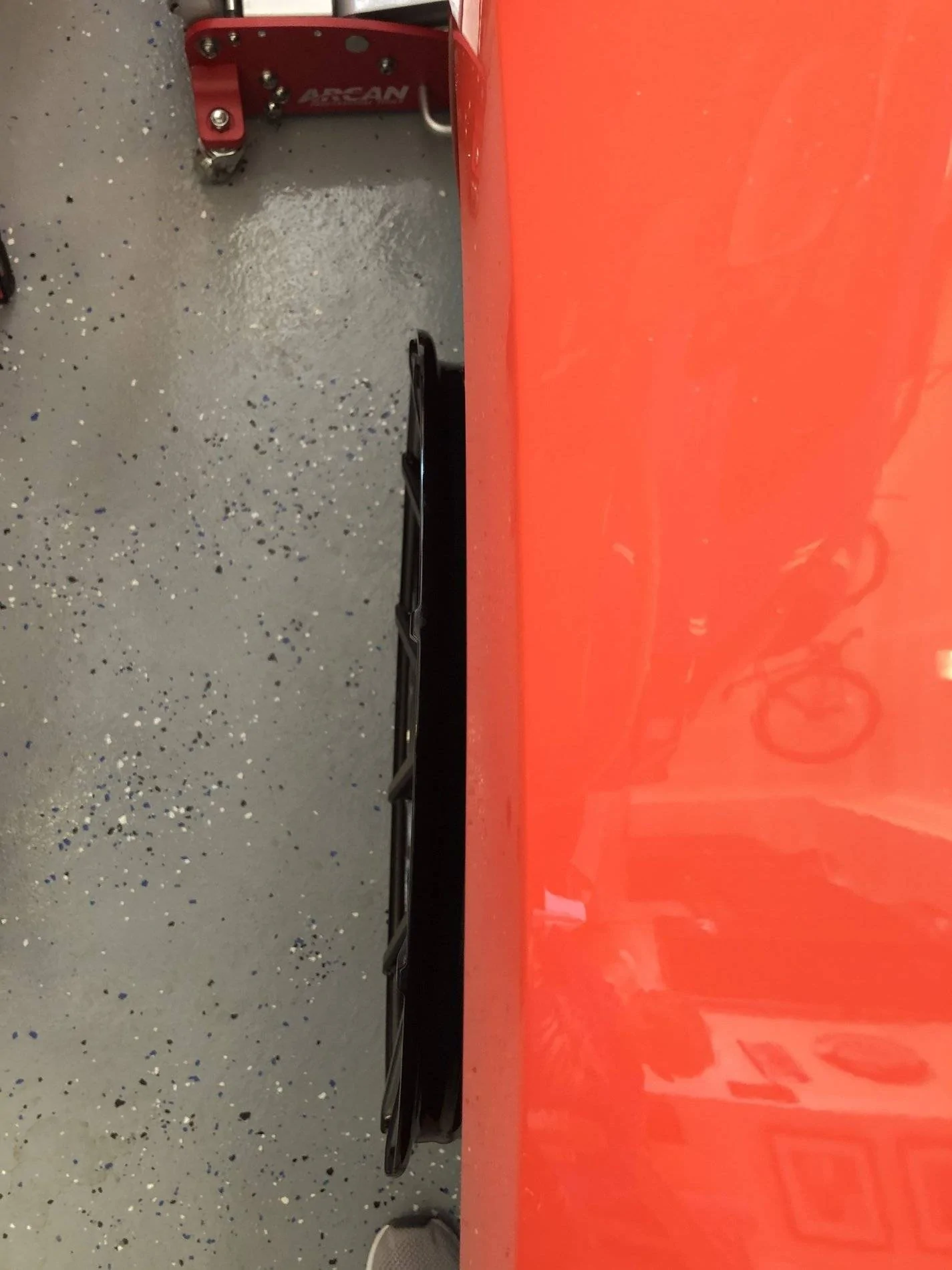

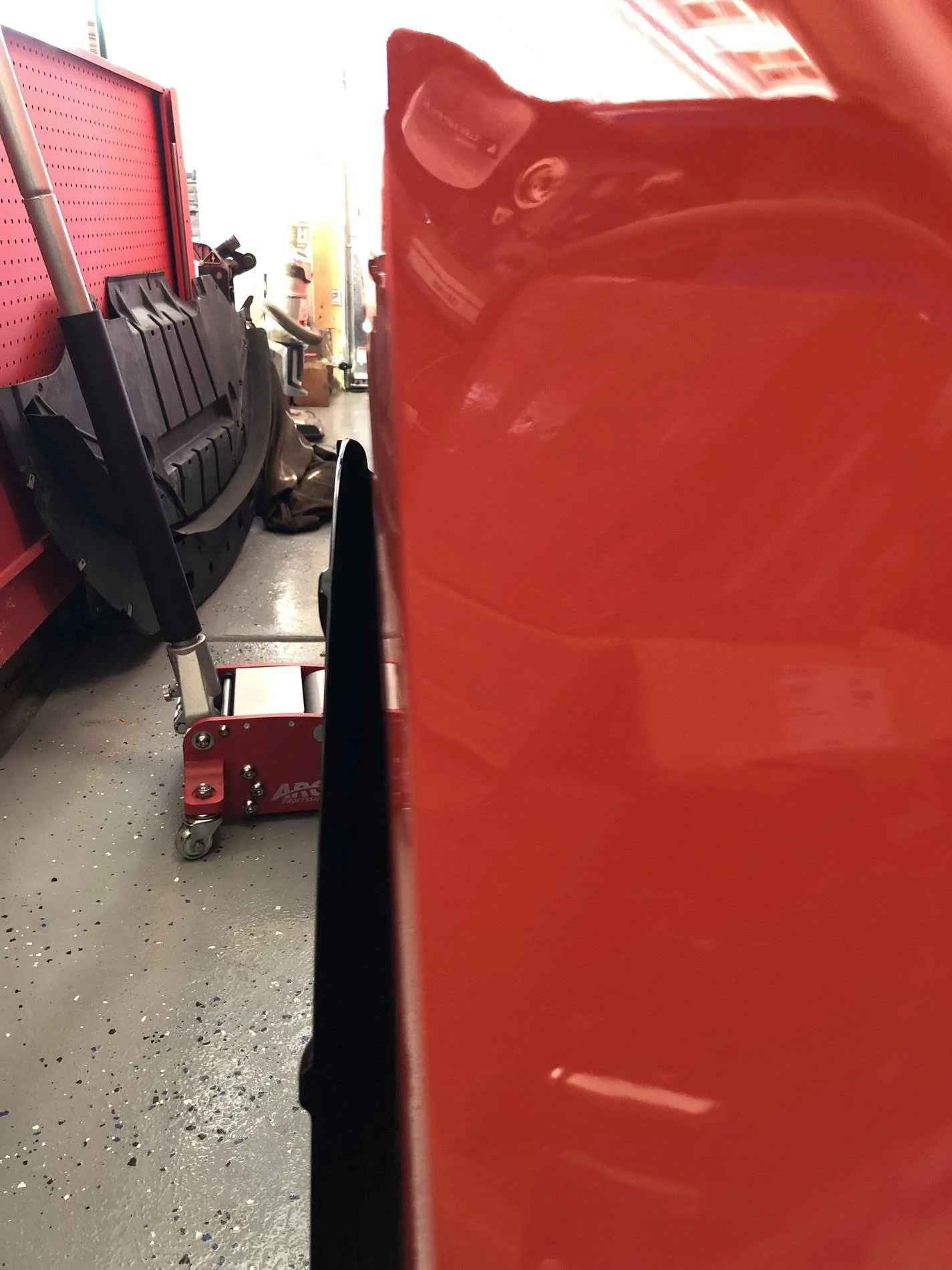

Hey everyone, I just purchased a square set up for my 15’ and test fit them a few mins ago. They are 20x10 (35mm offset) Rotiform KPS wheels. I really wanted a flush fit and from all the pictures I’ve seen, these wheels should sit pretty close to the edge of the fender. But, when I test fit them, they look to be sticking out quite a bit. Just thought I’d double check and make sure this is in fact normal. Perhaps when the wheel has some weight on it, it won’t protrude so far past the fender up front?
I’d like to confirm before I have tires mounted.
Thanks!

Have you physically measured the width and offset to confirm you received 10Wx35mm
I did, it measures 20x10 with +35mm offset.

Just double checking. With a straight edge placed across the back side of wheel bead lip measuring from hub face to straight edge your around 6.877” (6 7/8”) backspace ? That’s based on your wheel width measuring 11” from outside bead lip to lip.
Yes, the backspacing measured out as that. The wheel is also stamped “ET 35”.

Send them back! Those wheels don't fit, the tires will rub when mounted, and it looks horrible! Just my $.02!

It doesnt make sense that +35 offset would poke that much. Something is wrong.
