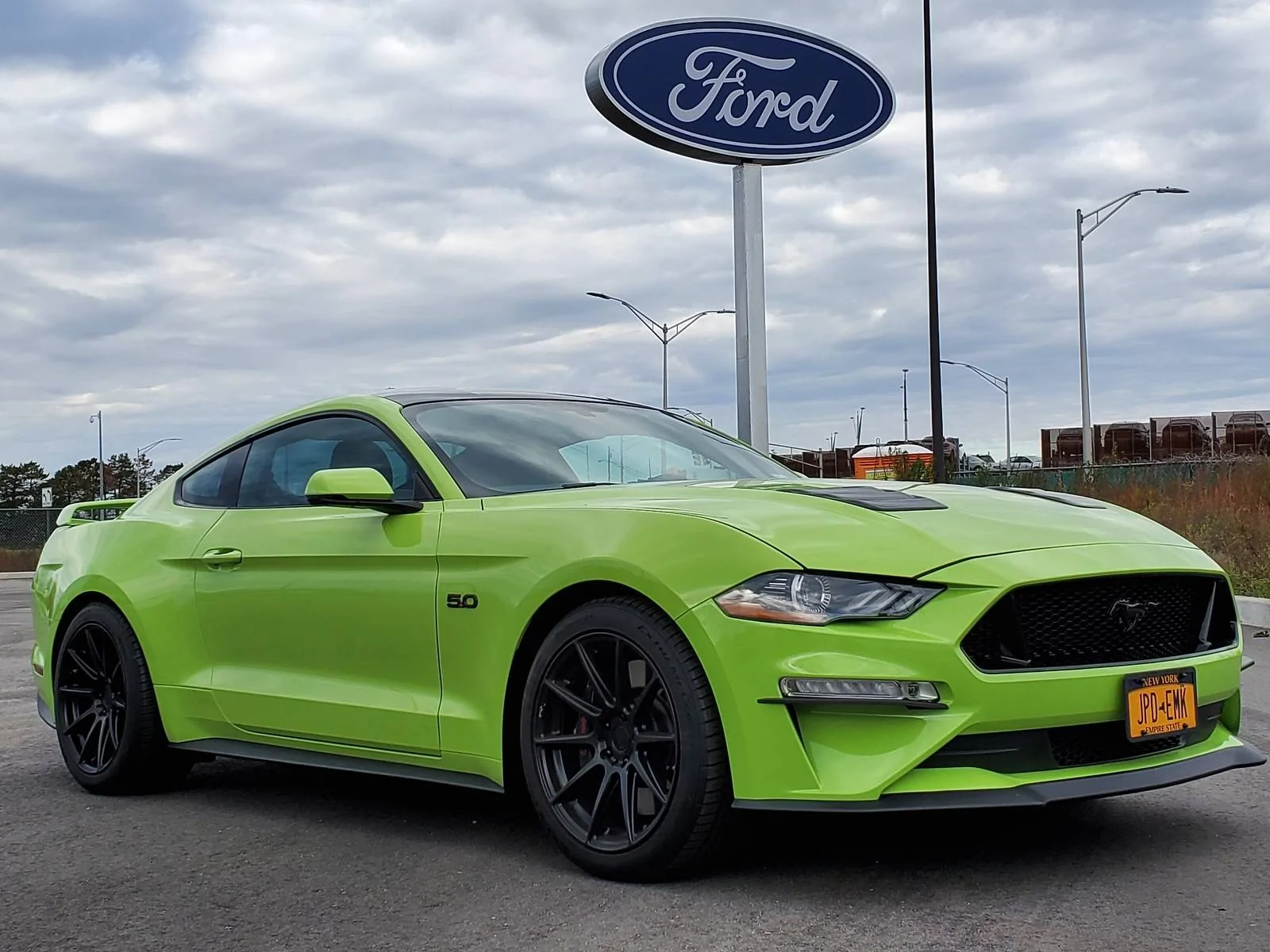

I've been running 19x10 squared with 275/40/19 on all corners.
Fits like a glove. Not lowered, but Magneride.
