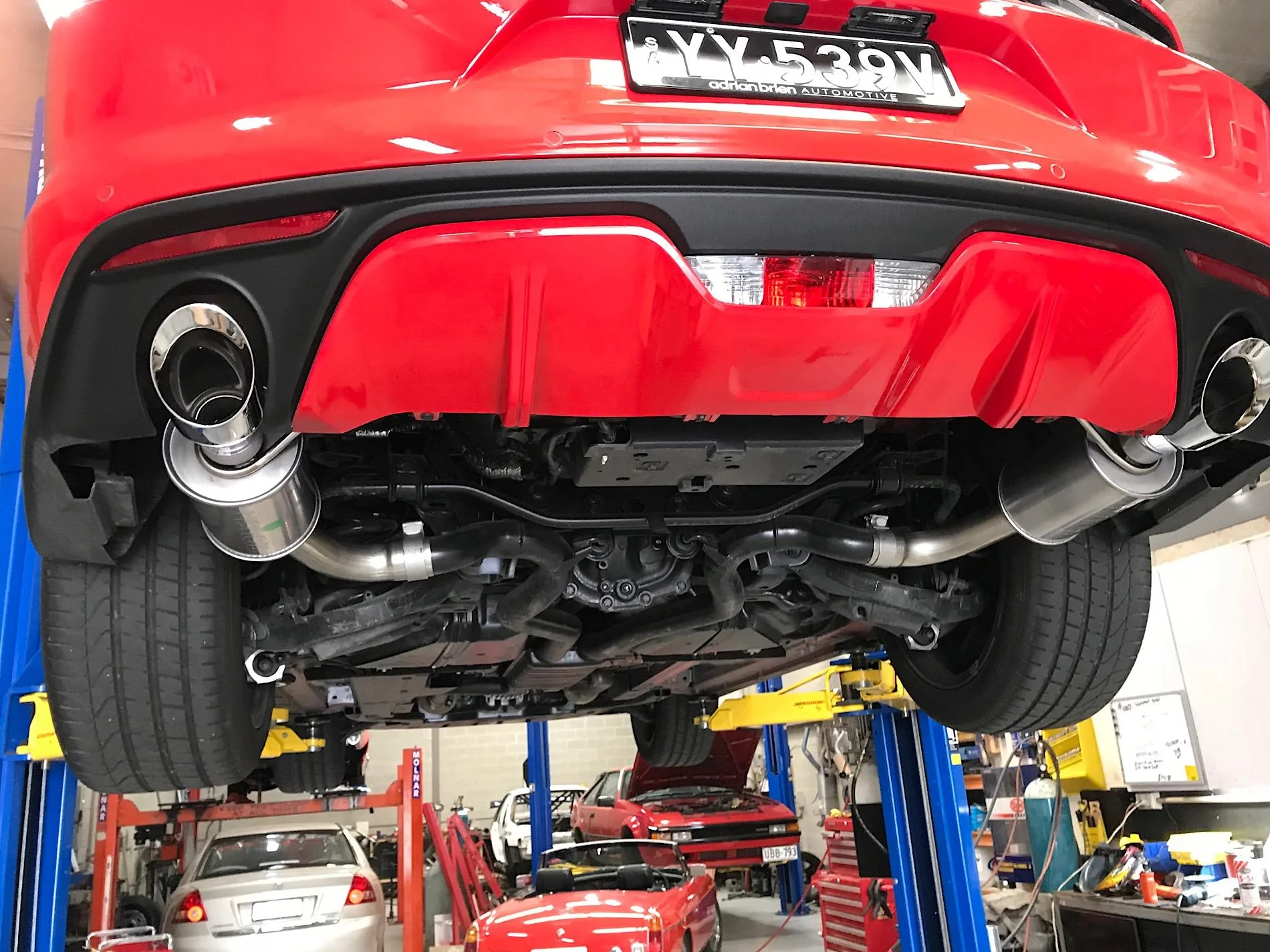

If you’re just wanting a better sound, I’ve got the axle back Roush and that gives a nice deep sound, no drone and I can easily re fit the standard mufflers if needed. $$$ weren’t too bad and the Roush tips look good.
I second that $875 delivery. Bang for buck is unbelievable, sounds wicked :cheers::headbang::thumbsup:

I like that look of that axle back system...
Seriously mate you can't go wrong with it. Sounds fn beautiful old school sound with no raspiness and relatively cheap and easy to install your self :thumbsup:

The other thing I’ll add is when it is first fitted, it is nuts! So fn loud, I thought I had done the wrong thing as I don’t want to be pulled over for too much noise, seriously it was loud!
But once it is warm and you’ve done about 1,000 km with it, it settles down to a kind of legal loud...
But when I start it cold for friends or onlookers, it gives you a big nasty bellow that makes me happy!
Give it the loud pedal in a country area where it is zero to 100km and you will love it!
snakebite recommended it to me and I’m so happy he did!
The only thing I would reiterate that this is more a cosmetic/noise thing rather than a performance thing.
I’ve cruised with a few guys that have Mustangs full headers, tune, superchargers etc and they will always be heavier in noise at idle, and nuts underload! Tn if you are out there!
But mine sounds great, is noisy at idle, barks and spits with manual up and down changes, and it clearly not standard.
If you youtube roush exhausts you will be able to hear it.
:cheers:

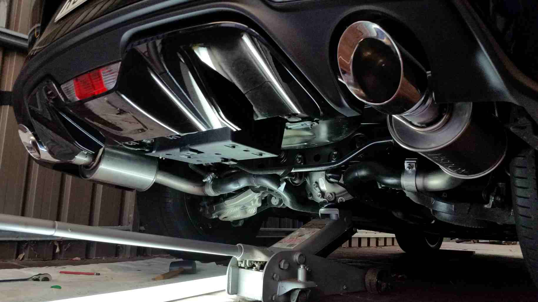

I was toying with the idea of doing the FPR X Pipe, then I managed to pick up a could not resist deal on a FPR by Borla "Sport" cat back system. I watched all the videos did my research so went for it. It arrived and we put the car up on my hoist and removed the stock system, I was amazed at how heavy it was, its heavy. We installed the FPR by Borla system and had a real issue getting it all lined up at the rear valance openings. the problem is there are 4 slip joints, the two at the rear mufflers were fine but at the outlet of the X Pipe the exhaust clamp pressure was not strong enough to hold the weight of the muffler section, and kept wanting to twist at the joint. the exhaust hangers allow some movement and we just could not get the system to sit perfectly. so we got the system lined up using big cable ties to hold the mufflers exactly where they needed to be and ended up getting the TIG welding set out and putting neat weld tacks at all 4 slip joints, then tightend up the clamps. However, system sits spot on now, but the clamps still don't have enough oomph to seal the joints, so I have ordered in some serious duty stainless steel U clamps to replace the band type clamps supplied as standard.
next thing I will do is get my cutting gear out and open up the stock resonator and mufflers to have a look inside, (get some pics) then take it all to the scrap man. the stock system looks pretty average when you have a really good look at it off the car.
the system sounds absolutely unreal now, its loud. cold start is immense. all the videos and things I have seen pre purchase understate how much the system transforms the sound of the car inside and out.
