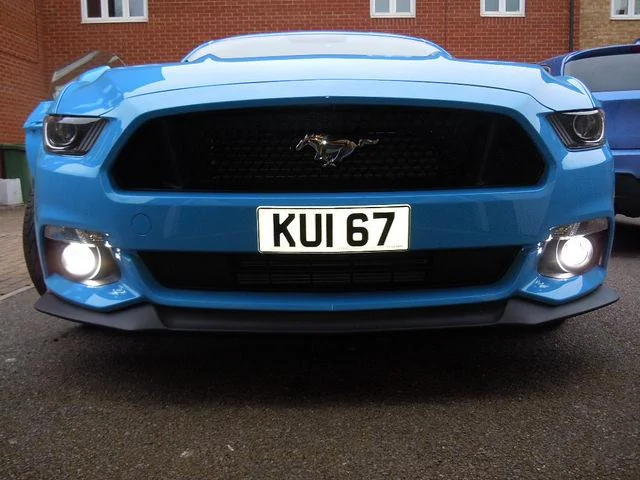

Certainly not a bulb ! Replacement unit. The Fog/DRL housing is held on by 3 x 7mm self tapper bolts and can be removed in 5 mins, access through the wheel arch liner,,,..Dead easy, dont even have to jack up or remove the wheel,
why Ford charge so much beggars belief! ..:crazy:
Because unlike the set you sell and I have on my car, these totally change the appearance to a halo, there's also osram ones from TRANSITs that fit that makes a C shape DRL. the fog hen also becomes an LED with the kits (Both osram and this NAVCO one linked above). They're also so expensive because they're totally different.
Consider this mod like swapping your seats out. It's still a seat, but it's a different seat.
Yes i know what you are saying Steve and good to have something different i agree.. It was the fitting charge that Christian quoted that amazed me..although he was guessing at it i imagine...:eyebulge:
The unit comes easily out in a matter of minutes, and an easy DIY fit, unless extra wiring is involved for some reason..
Our Fog/DRL lens are made by Valeo..and not the best of quality to be sure.
Not sure i would justify spending £300-400 though tbh ..as lots of other tarty things for that money... :thumbsup:
IN FACT for £300-400 i could even take a tart out for a night .. :lol::lol::headbang:

It's a lot of extra wiring for the osram kit.

the Ford fit DRL/Fogs are also an option, but an expensive one. It's about £400 split 50/50 between labour and parts as it is a fiddle to do. They're the ones from a Focus as it happens... http://www.ford-accessories.co.uk/s...hts-+-fog-lamps/1875877?model=focus&year=2011
Mind you, I've got them and am very happy with them.
Did yours fit properly? Mine don't. See pics - they leave a gap at front
. (Ignore the chrome trims in pics - they fit perfectly on the exterior housing.) Old fogs were perfect fit. But the new fogs screwed perfectly onto the three screw-holes and placement nipple - but just don't fill the hole completely. I know you can adjust the angle of the bulb, but that doesn't fix the problem. I've heard of others with same problem.

I see the problem, Mine seemed to fit better, but the gauze over the top to knock them back a bit makes it a bit difficult to tell.

The Ford-Navco ones are good - once you've sorted the odd fitment (I used a rubber seal, and some chrome trim). And they are warrantied for a year.

LEDs do improve things. I got mine on eBay for £180 (normally £200 but there was a 10% off flash sale on eBay)
