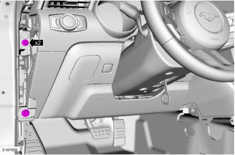

So I think I got all the bolts and clips off the dash, but it still wont budge.
The only things I haven't taken off yet are the side bolts that connect to the metal bar that runs behind the dash. Do those bolts need to be removed (pictured below)? I didn't think the whole metal bar comes out with the dash.

You got a ways to go, also it looks like you removed a TON of stuff you didn’t need to touch. I pulled my dash following the motor craft instrument panel removal guide. You can buy 72 hour access to it (looks like you may have already done this).
Based on what I see in your pics you still haven’t pulled the 3 large silver bolts (pictured in your attachments) the 4 bolts that you’re asking about (once you back these bolts out you CAN NOT shut the doors), and something that IS NOT in the motor craft manual is the fact that those bolts you are asking about have some sort of nut on the inside of the car that you need to unscrew as it is pressing the dash against the sides of the car. There are also two little kick panels that you need to pull off, one is beside the gas pedal to the right, and the other is on the passenger side in a similar spot. This will reveal 4 bolts, two on each side. You also need to remove the center console as it has pegs at the bottom of the center stack that will hold the dash in place or get in the way. Since you have an auto there are additional steps you need to take with the shifter, mine is manual so I just had to put it in 4th.
Once you get all of that done, you’re still not out of the woods... pull the drivers side out directly towards the back of the car. The A pillars are clipped into the dash on both sides. When I did mine the drivers side seem to come out with a pretty hard tug and jerk. The passenger side we stared at it for about 20 minutes before I said fuck it and yanked on it from the drivers side, didn’t break anything but I got lucky. The dash will balance on the center stack. Take this moment to make sure all of the connectors are free from either plugging into the dash harnesses or stuck into body panels. There are two plugs hidden inside of the A pillars on each side of the car. One for side curtain and another for the tweeter, pull them both out, the airbag clip is going to piss you off pretty good. Make sure the gear shifter is not in the way or you have a plan on how to work around it. Tilt your rear view mirror up and out of the way.

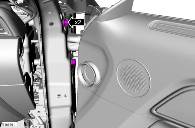

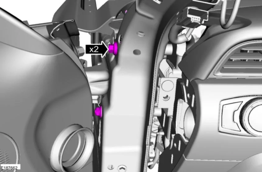

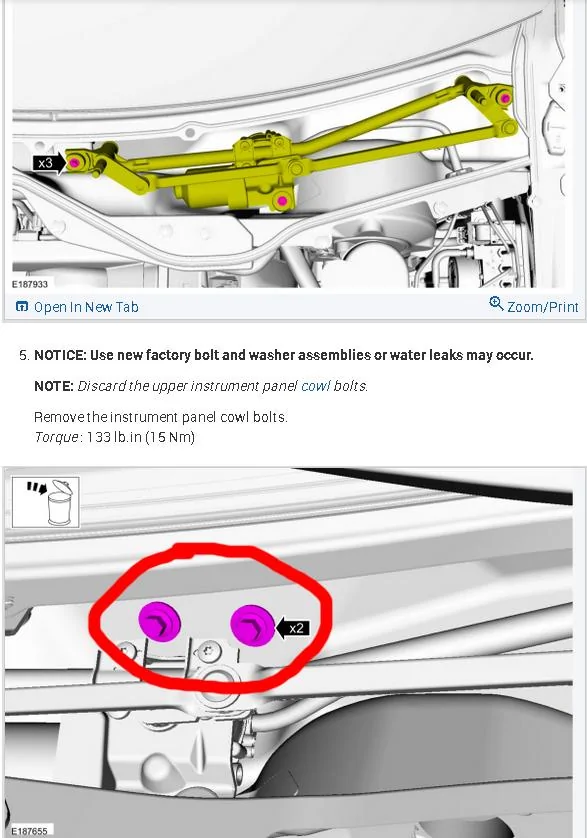

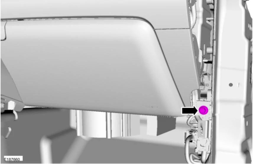

Thanks! I was able to grab some pics real quick from a friend that has alldata.

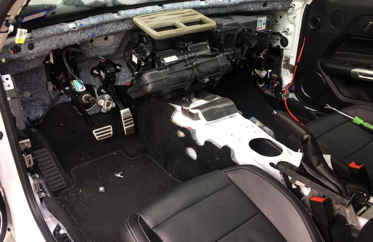

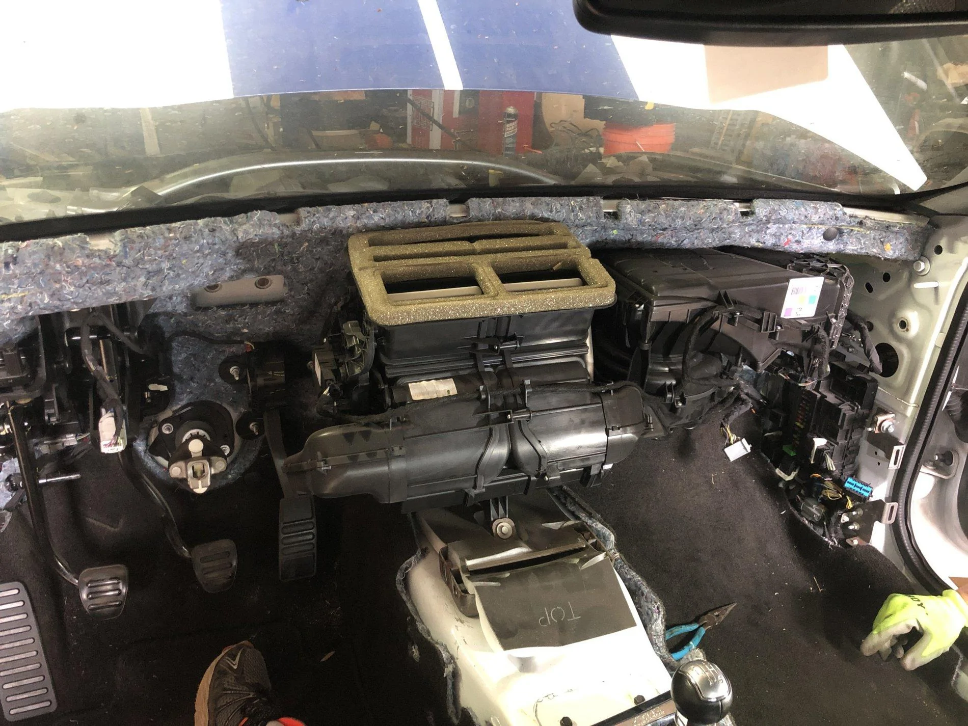

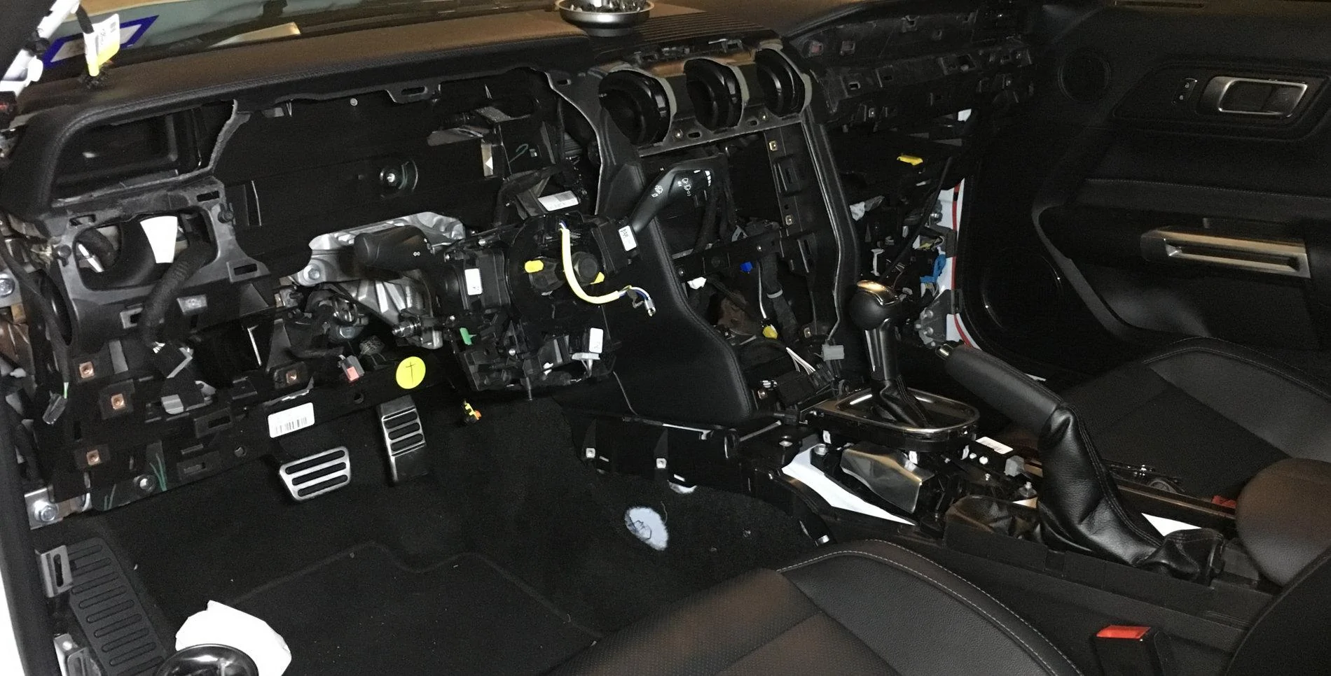

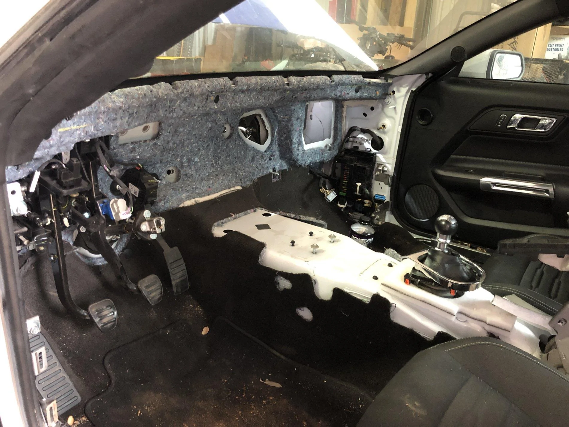

Since the first pic:
I pulled the center console out, shifter out (major pita since you have to maneuver around the exhaust and driveshaft), unbolted the torx bolt holding the steering column, and got the 3 large silver bolts out.
Oh wow did not even realize those were jam nuts right there!

Anyone know what the part number is for the 2 bolts with the gaskets under the cowl? The factory gasket look weird and not too confident on the rtv.

Just updating this thread with a part number. W715969-S442 for those 4 bolts with the squishy gasket.

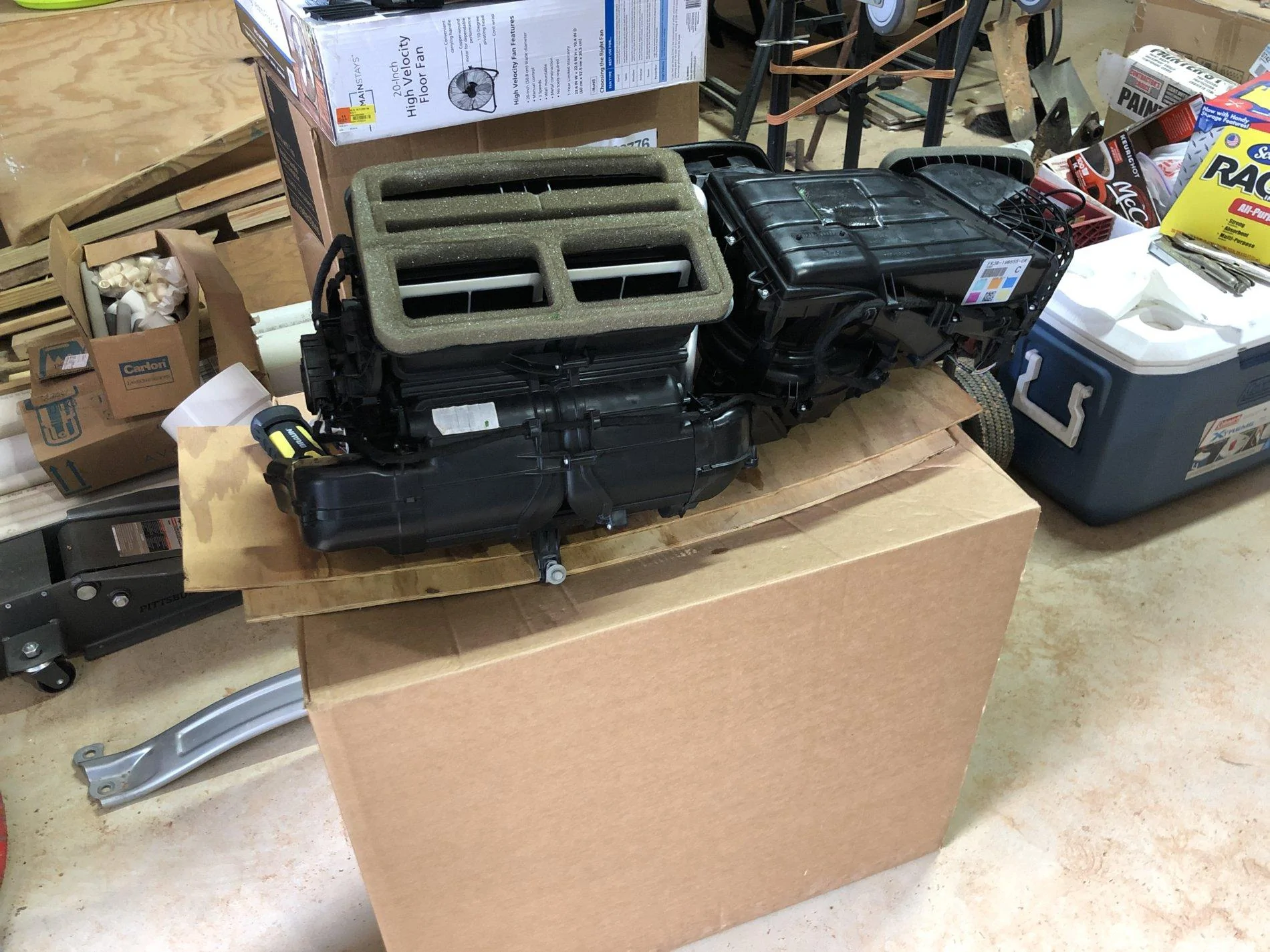

I know it’s been a while since this thread has had any action but I am stuck. I have the dash removed and I have one last bolt that needs to come out to remove the heater/AC plenum. It’s the bolt dead behind the engine about 12” down from the two bolts that hold the dash in. Please tell me what specialized tool do I need. A 8mm socket and a swivel headed ratchet(with a 16”handle bent to the shape of the motor.)??? Some air tool? Remove the engine?(not happening).
