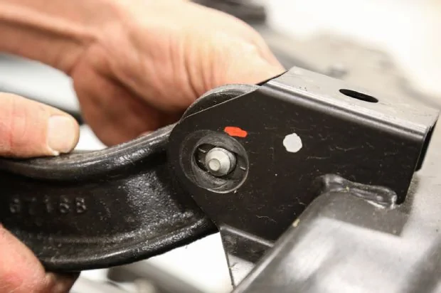

I thought this may help some of you who have lowered or are lowering your Mustangs.
Having had a number of questions relating to rear camber adjustment after lowering here is a pic of where the camber adjust is.
It is somewhat hidden and sooo many suspension shops are not even aware it exists.

Fred that's a good amount of camber adjustment on a factory upper control arm for a 1" drop. I thought I would need to spend more money on a performance adjustable upper control arm or camber kit. I'm installing a Ford Performance Street Handling kit which gives you a 1" drop.
