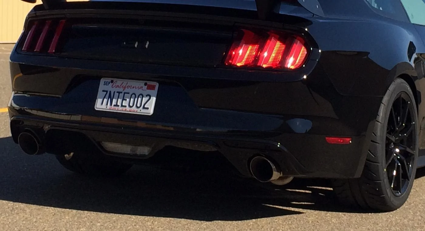

Here's a pic showing what it looks like if you just remove them, and don't plug the small holes left behind. Nearly unnoticeable....
