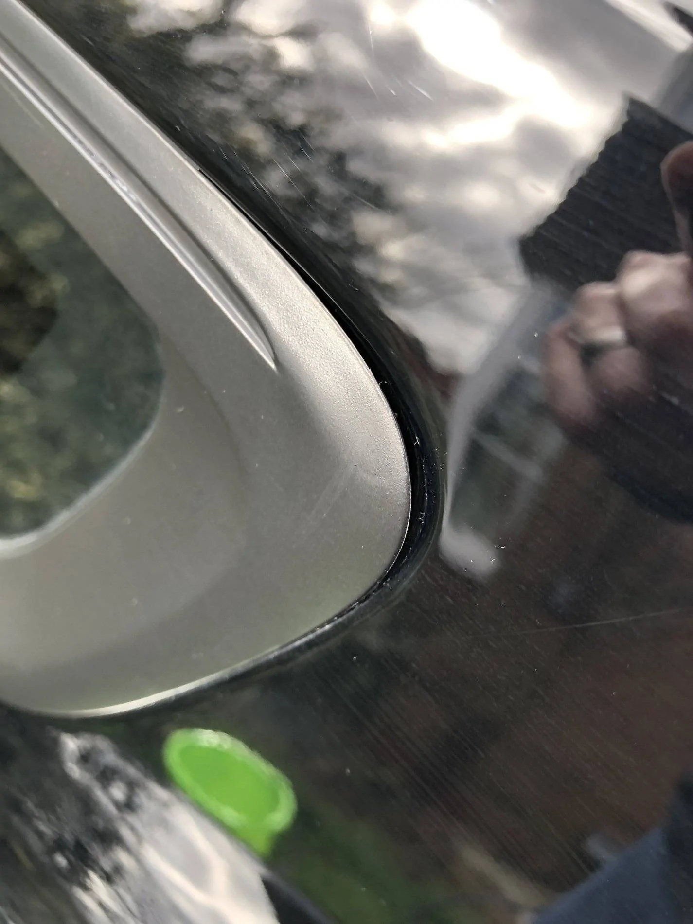

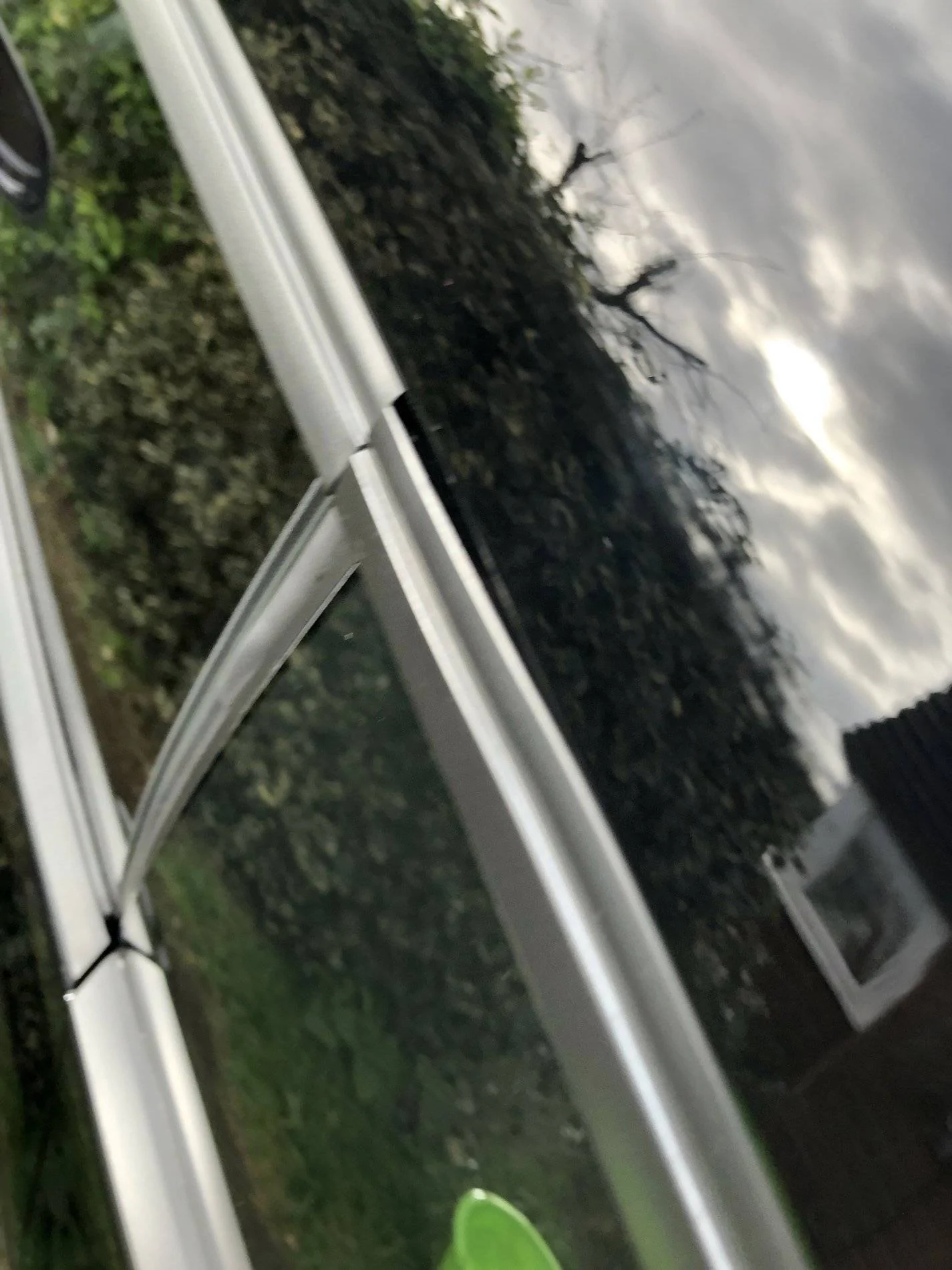

Have owned a 2019 GT for 2 months and noticed the window trim lifting on the rear quarter. Both sides lifting where it buts up against the door and in the far curved corner. Worried about water getting in. Is this a dealer thing or will 3M tape be OK?

dealer thing its bonded in get it back on warranty also wtf have you washed that with you've got some mad scratches in that

Not scratches just streaks. I only wash it by hand. Thanks for the reply. Will get it looked at under warranty.
