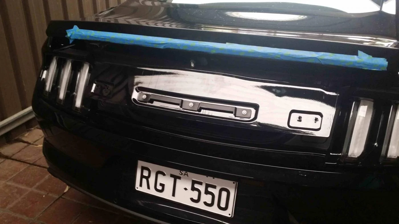

Thanks snake bite; that gives me confidence to give it a go.
No problem. There is a good how to vid on cjpp web site. Buy some cheap trim removal tools from supercheap and musking tape to protect the boot lid

It is a fairly simple install, the only issue for me was trying to align the bolt holes on the bottom of the decklid

I agree the bolt hole were a bit out of alignment but still went in okay, I did mine twice because I put the friggin camera in upside down!! Idiot

Just did mine today (Thanks 2-Stang). A relatively simple job. The force needed to get the old lid off seems excessive, but in fact its fine. Go DEEP with your removal tools rather than expecting to pry it off with them shallow...The new lids look an absolute treat. I'm completely smitten......
