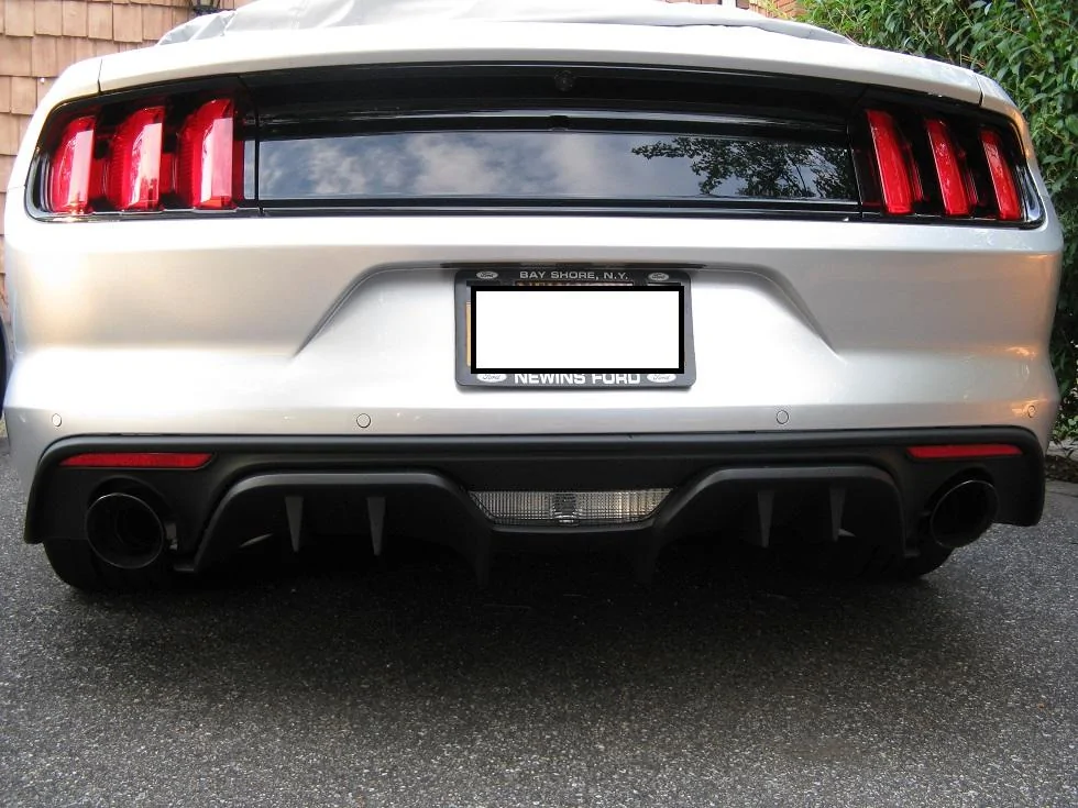

I did that conversion last summer on my 15', although I bought mine from Levittown Ford I did notice at the time that the reverse sensor bumper was cheaper then the non sensor....although I have the reverse sensors so I was not complaining.
I also did the RTR diffuser...:D
Lookin' good. :thumbsup:
I remember you and I discussed your purchase from Levittown in another thread and how they're shipping charges were exorbitant. You even provided me with the address, I believe. I just don't feel like driving all that way and back so I may just get it from Tasca's website, though they are not much better with shipping ($282 plus a $75 dollar core charge :frusty: :mad:)
Looks great. How much was the bumper to get it painted? Did you have to buy any extra hardware or anything?
The bumper painted was $400, The only extra hardware were the 6 metric screws.....3 screws per side, for the valence to attach to the premium bumper. Since I don't remember the exact size...I think 7mm, I just removed the slip on nut off the bumper and brought it with me to the local hardware store....
