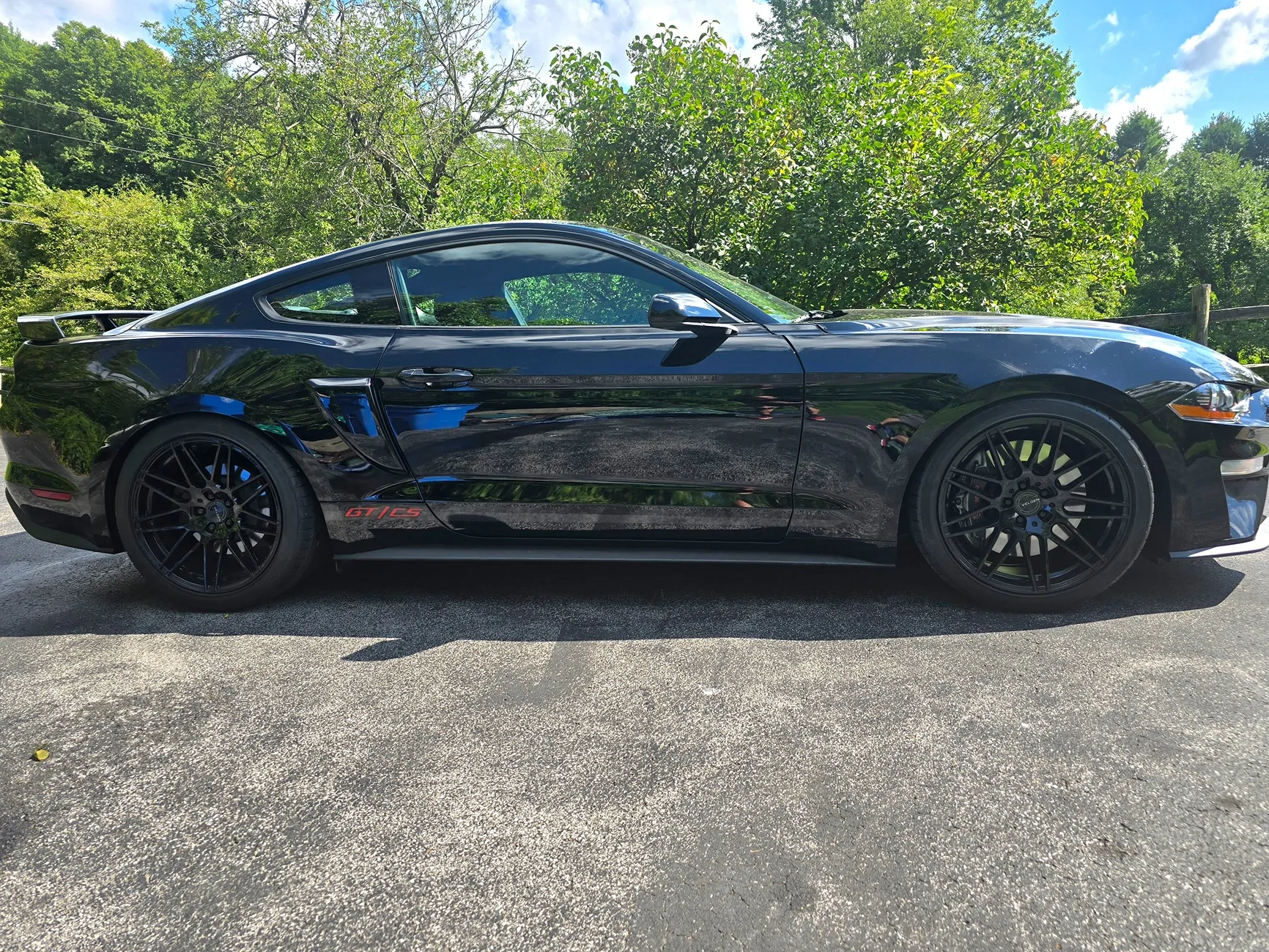

So my car with 40r19s and the fptp puts me at a ring finger gap in the front and a index finger and middle finger gap in the rear. Don't have a tape on me as im about to leave work. From what ive seen/read with springs before buying this setup, im pretty positive Midway is correct in saying those sportlines would be what you looking for as far as springs.
