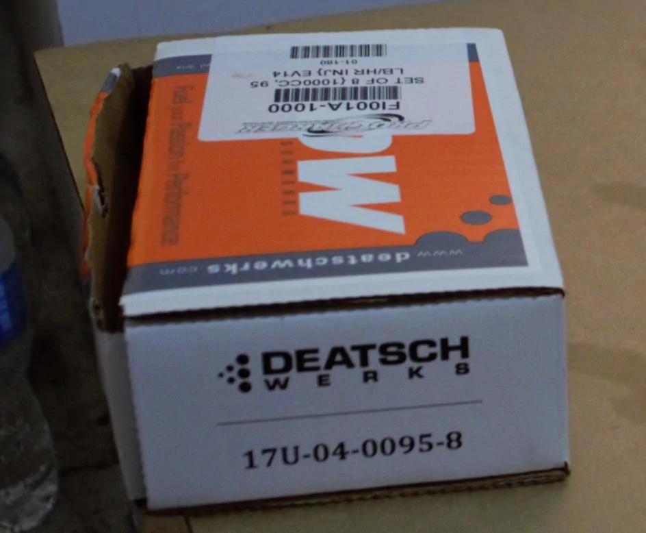

The kit came with DW 95lbs ?

mine did, yea
ordered the complete kit from beefcake, placed the order early march?

mine did, yea
I would call Procharger Monday , I'm sure they will fix it ..:thumbsup:
