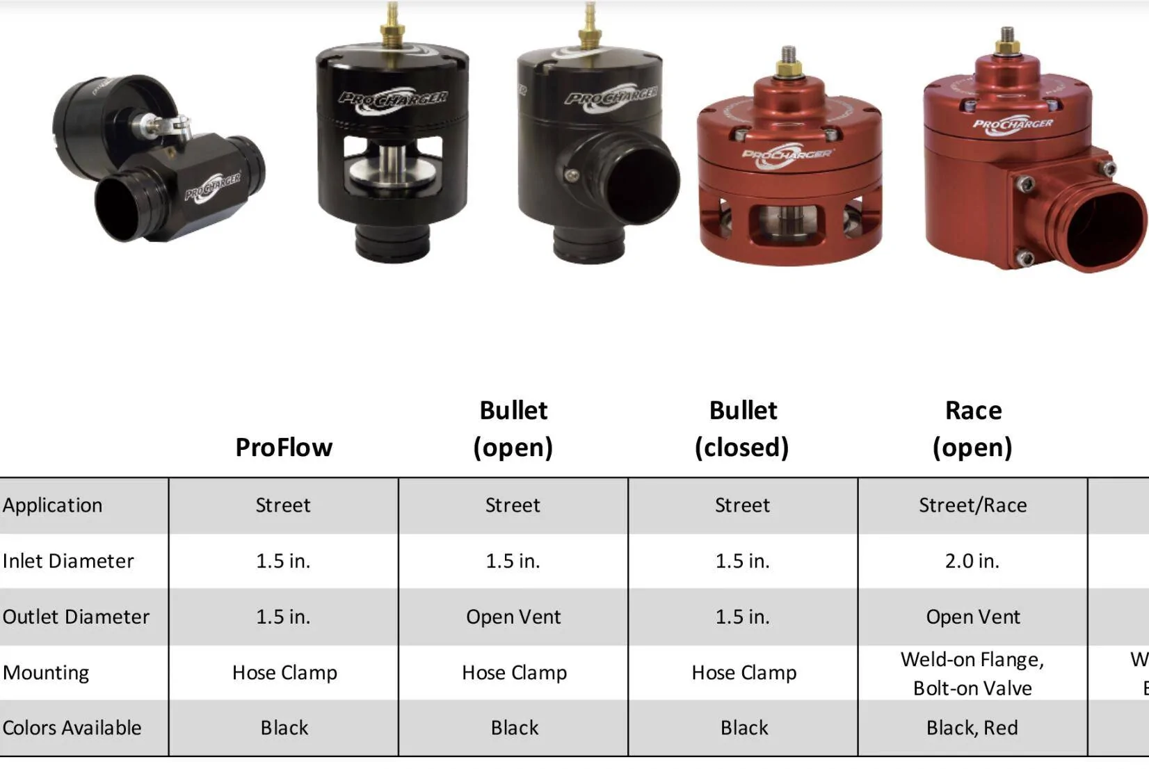

I want to change out the BOV on my D1x kit (2019 Mustang, Lund tuned) to the race red valve. I believe it has the Proflow or the factory one on it now.
What all do I need to do? Do I need to ask Lund for a new tune?

Tune has nothing to do with your BOV
All you need to change is the flange or piping that your current valve is on, so that you can fit the larger red valve.
