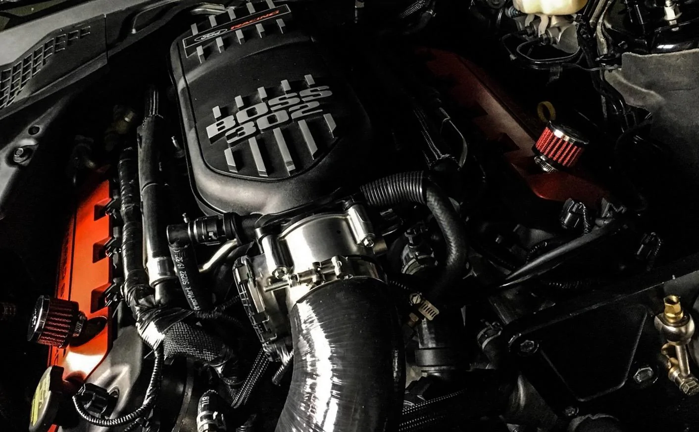

I'm running breathers with no complaints at all. Working perfect!
Don't mind how dirty everything is. lol
Did you gut the passengers side one way valve? The reason I ask is that your drivers side is dirty, passenger side is clean showing it is not opening to vent which is indicative of the valve not being gutted since there is no vacuum to pull it open anymore. Just wondering :)
