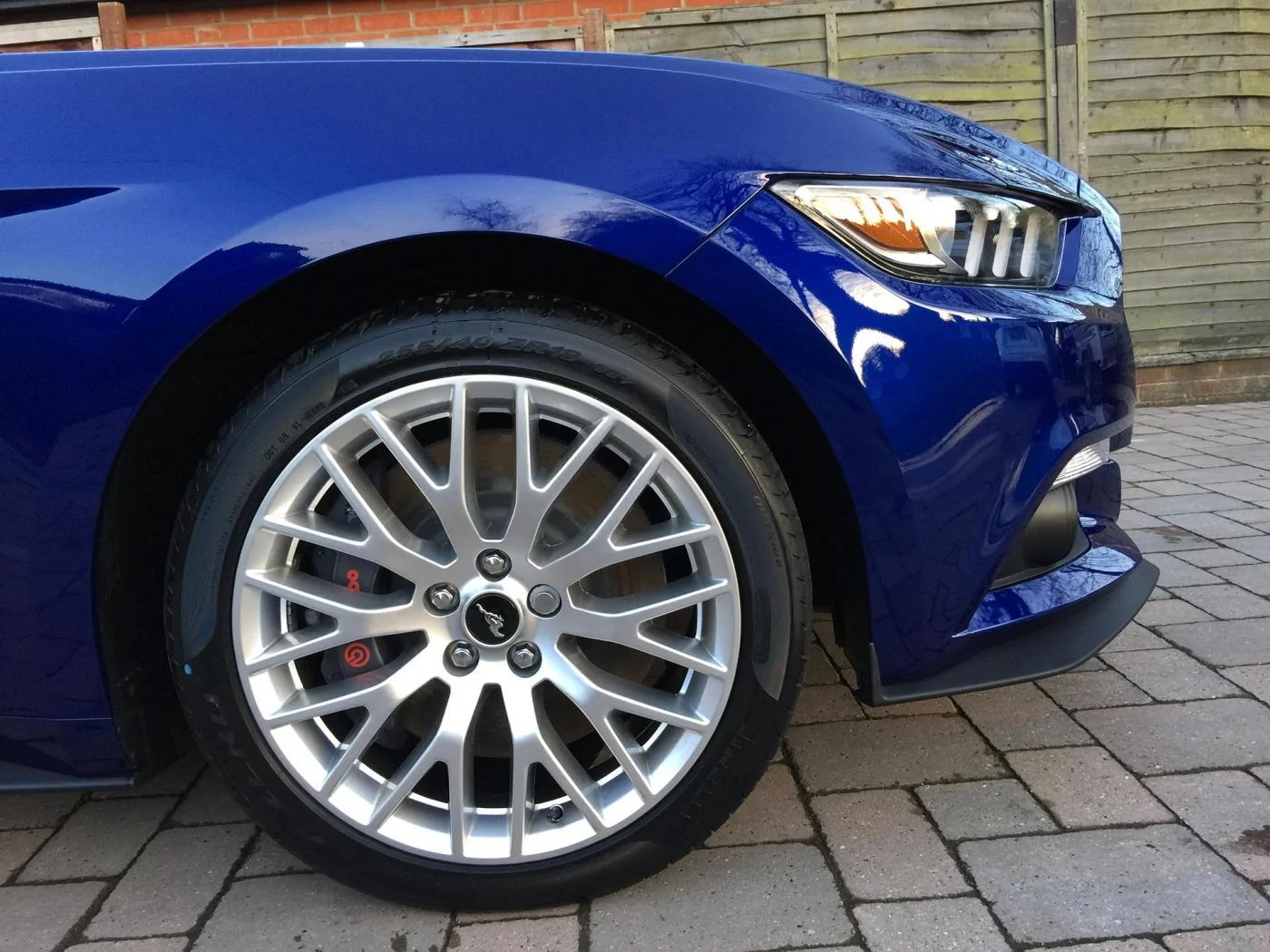

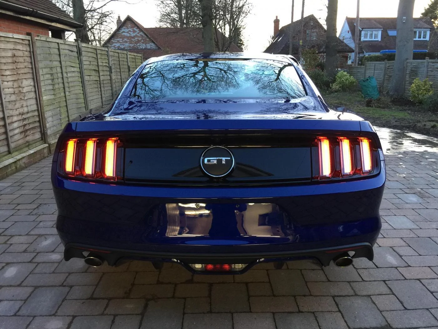

So, wheels clean, polished, sealed they were put on and tyre dressing applied.
10 hours in today and so just a couple of pics before I lost the light.
Work not finished quite yet! :doh: But the end is at least in sight.
Time for :cheers:

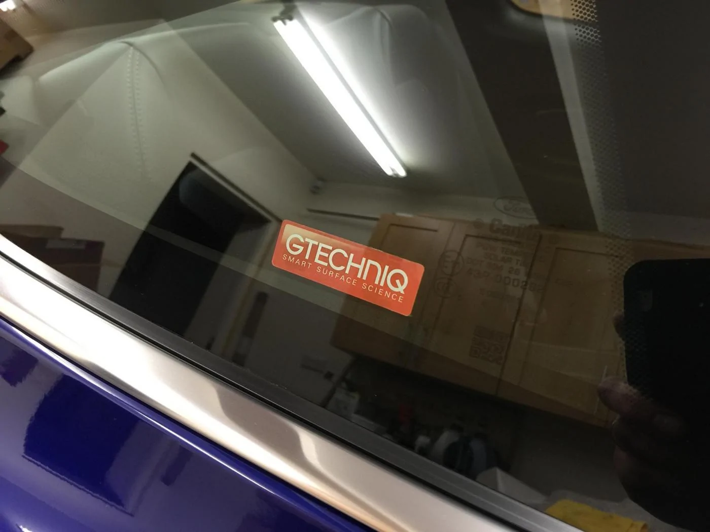

So, day 2 over, onto day 3.
The C1 would have cured overnight, so time to apply the final stage in the paint protection process, the Gtechniq C2V3 Liquid Crystal.
Compared to the other stages, this is a doddle. Just spray on and buff off. Saying that, it still took a few hours!

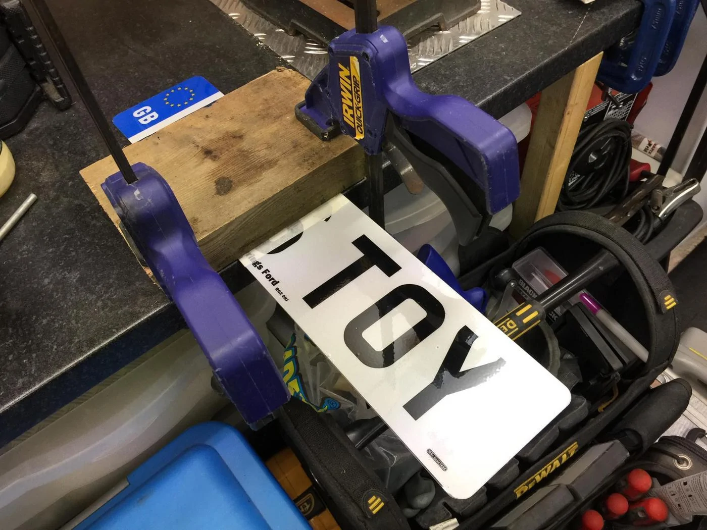

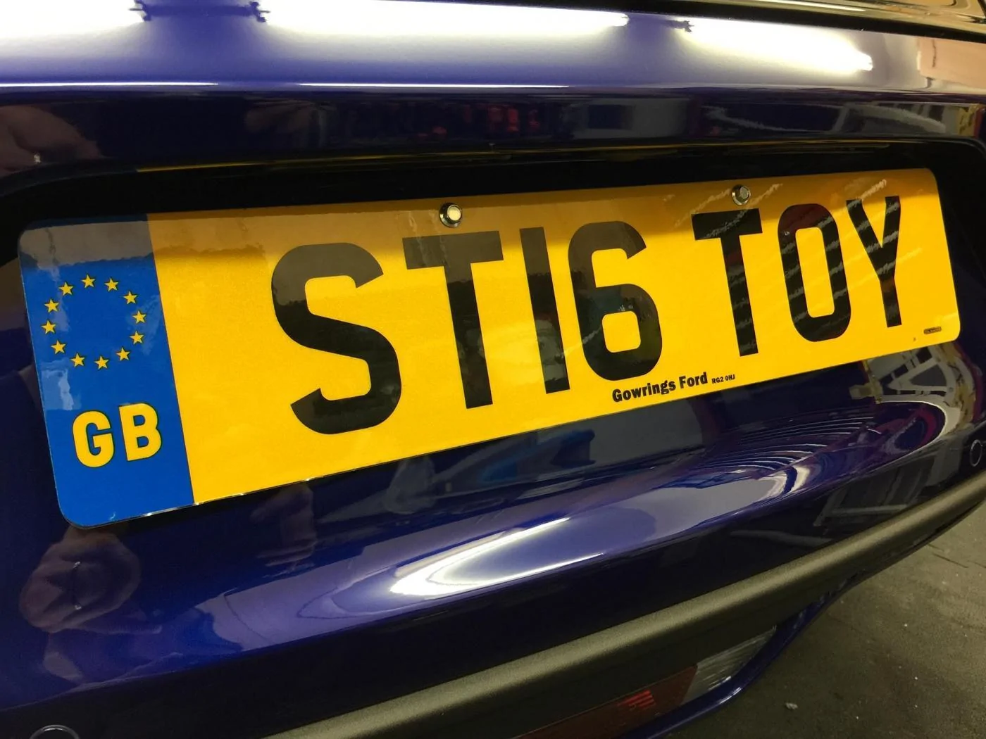

Re-mounted the rear plate. Decided to install using the US plate fixings, but using some stainless selt tapping hex fasteners I had as the ones supplied with the plastic brackets are HUGE and black.
The front plate was formed to adhere to the bumper, but as I've got a Stow and Show to fit, I've left it off for the time being so I can order a US sized plate.

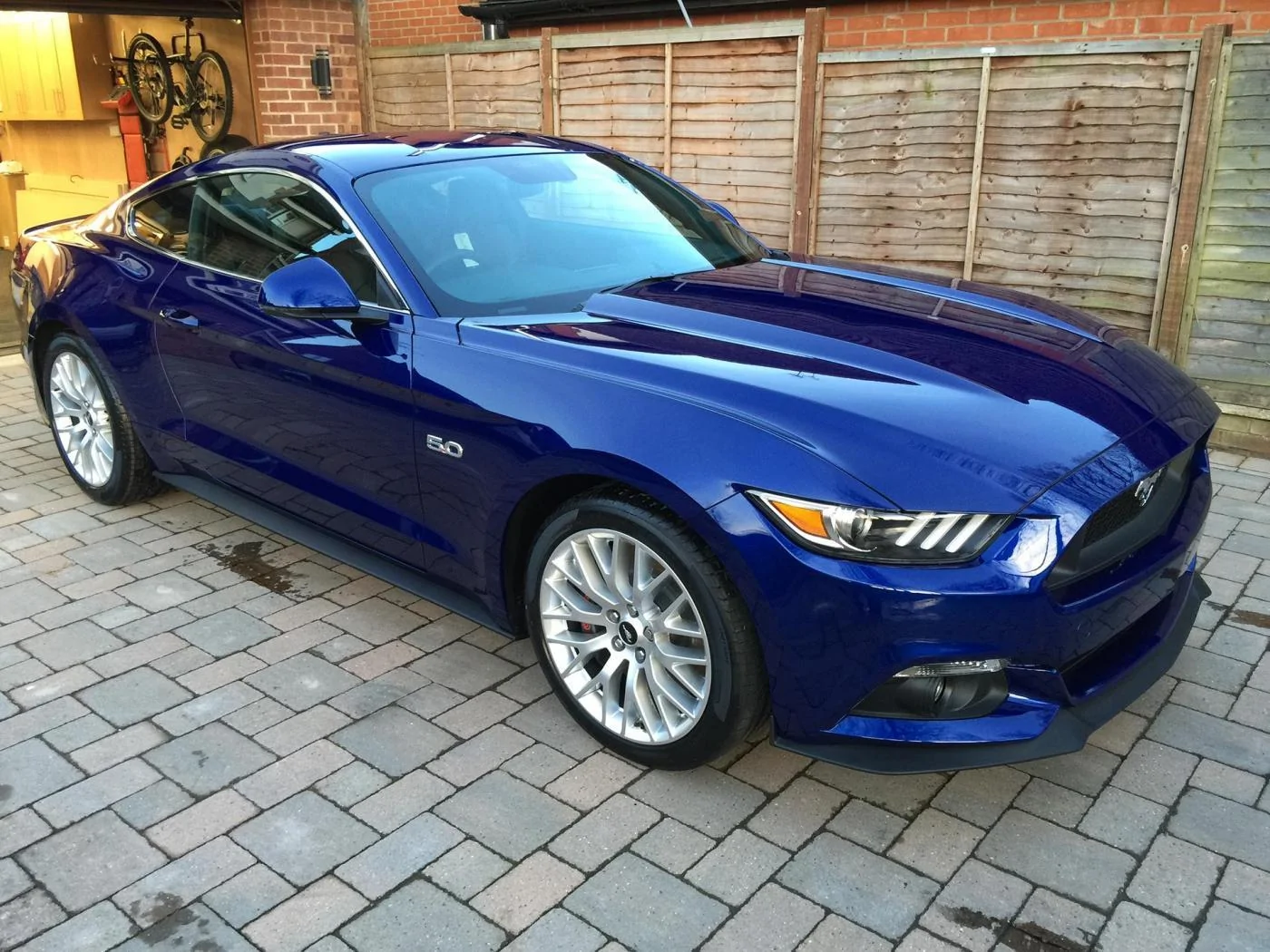

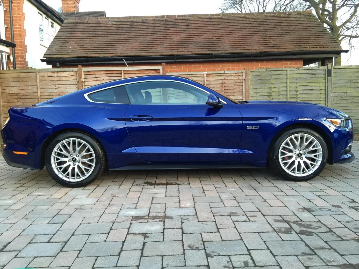

So that's how you prep your own car. Or at least, how I do it :)
Believe it or not, I was smiling in this pic, but the light was fading :thumbsup:

For these wheels, it was well worth investing in some decent brushes. They are a right fiddle to get inside especially around the Brembo calipers - so a decent set are well worth it.
[MENTION=18440]stiggy[/MENTION] - Fantastic job and loved reading through this! I thought i spent loads of hours prepping mine :)
One question, where did you get your wheel brushes from? Mine seem a little harsh and not sure long term if they will start hazing the black alloys, so need something softer to slide through the spokes / reach the inner rims.
