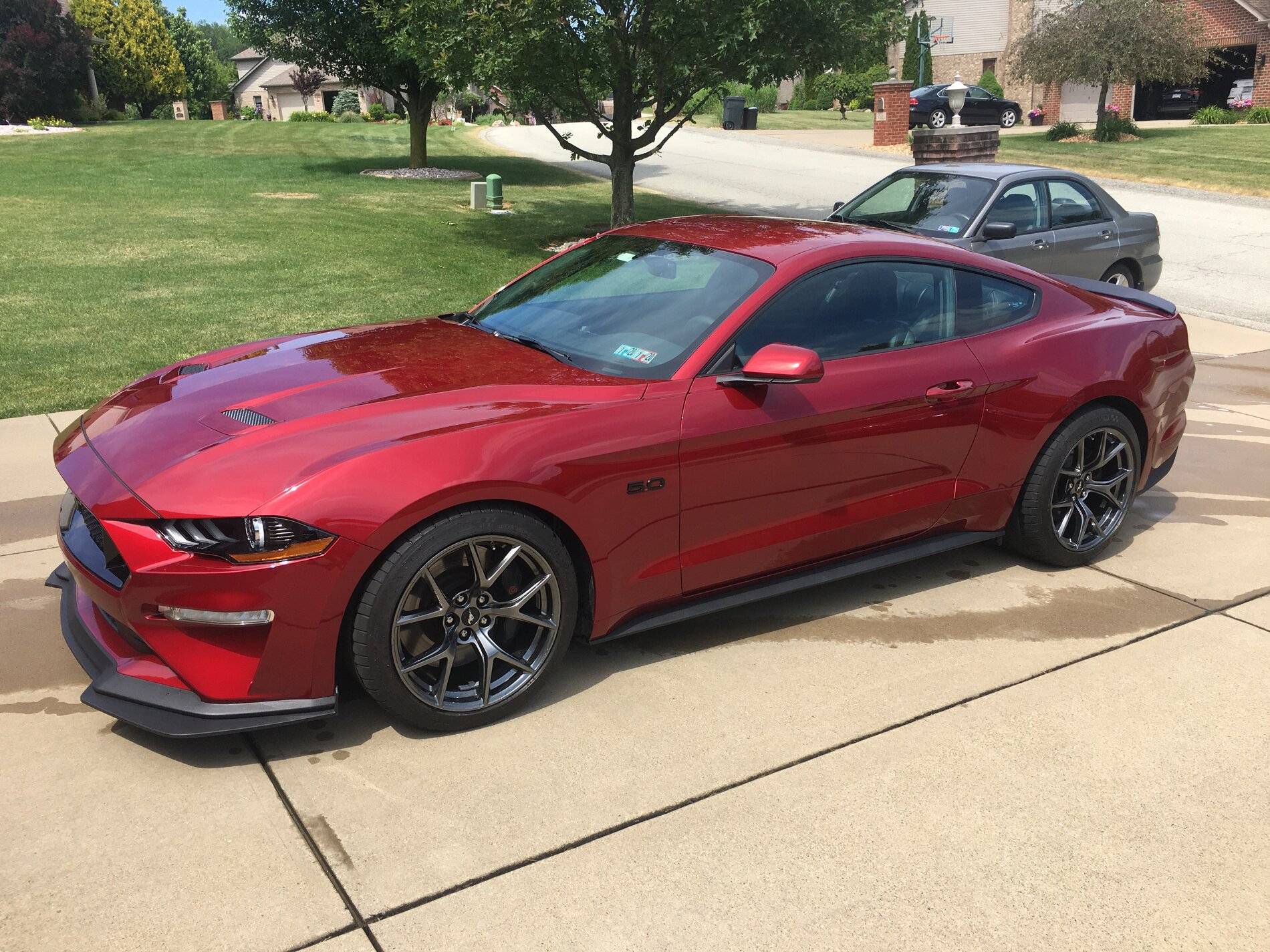

FWIW I ran both GT350 and PP2 wheels on my PP1 with no clearance issues.

The inner diameters of the two wheels are the same so only reason they might not clear the brakes are the different offsets... +24 for the PP2 and +30 for the GT350.

The GT350 wheels are gone but I may consider selling the PP2 wheels in early June when my Mach 1 arrives... they have GT350-sized tires on them, 285/35-19 front and 305/35-19 rears. Had the stock GT350 295/35-19 fronts at first but dropped down to 285's for a little less tramlining.
