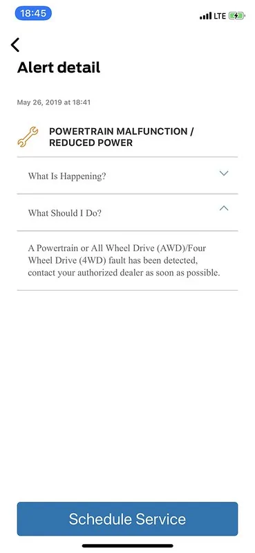

So this just happened - it was time to run some errands and fill up the tank, 33 miles to empty, so not bone dry. Since the car was light, I was going to go run a couple 0-60's before tanking up. Running in park in the garage, I set the drive mode to Drag, shift to reverse, and back down the driveway. When I put the car in Drive, I noticed the little wrench symbol on the dash, and a warning message. FordPass also showed a message with the same info:
First Fault by clair_davis, on Flickr
I can't schedule an appointment until Wednesday at the earliest, so I went ahead and drove it easy through a carwash where I set the drive mode back to Normal, then to the gas station. After filling up with gas, the little wrench went away, and stayed off for the remainder of the outing.

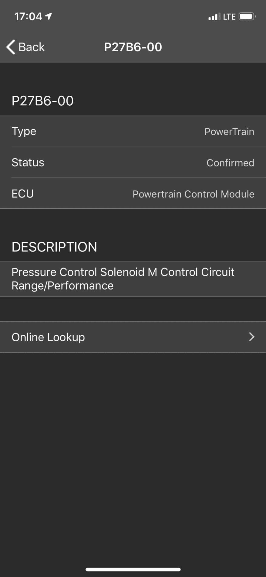

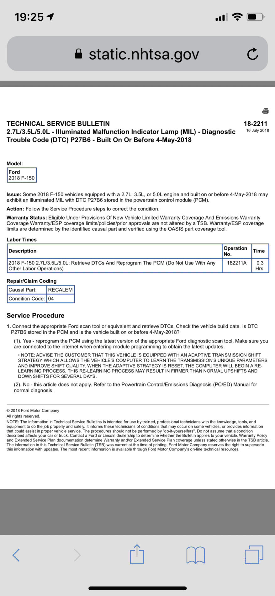

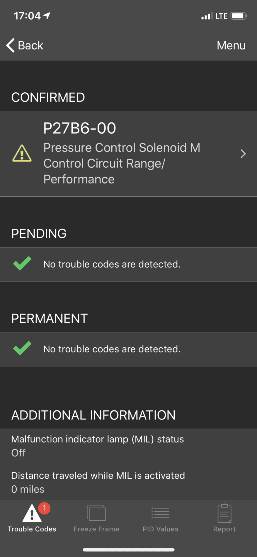

Update on this... I bought an OBDLink MX+ scanner and OBD Fusion app to see what the heck is going on. The code is p27b6-00, “pressure control solenoid”, and Google finds a DTC for ‘18 F-150’s under that code. Not a lot of detail given in the description, but it sounds like a reflash is the repair. I’ll take it in on Monday for an answer.

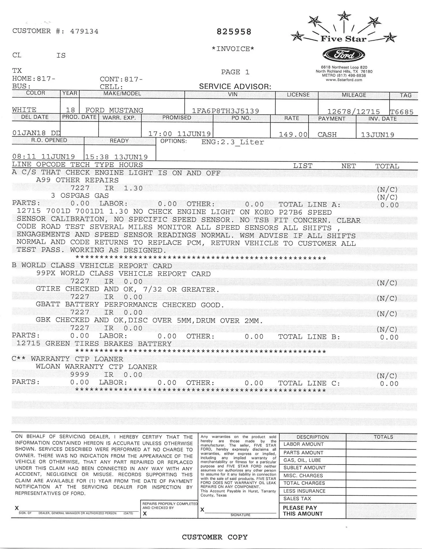

She's home with 48 more miles than I left her with, and a reset transmission controller. They claimed to not be able to find or recreate the error, so it's back to normal and keep an eye on things. I'll attach the invoice for the work so that if there's anything useful in there, maybe it will help somebody.
