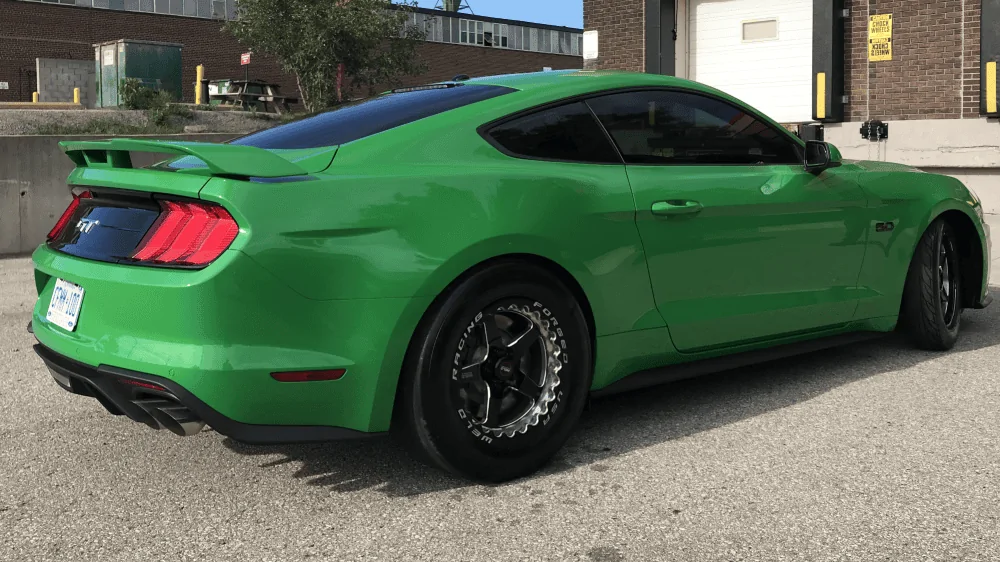

What are the tire sizes are you running and would you happen to know the wheel offsets?? Looks fantastic!Her first home
Thank you!What are the tire sizes are you running and would you happen to know the wheel offsets?? Looks fantastic!
Thanks for the info, I could definitely tell she's a bit lower. I'm lowered 28.5mm front and 25.4 rear but it looks like your's would tuck nicely if need be.Thank you!
Running 275/35 on the fronts and 295/35 on the rears.
The wheel offsets are et 35 on the fronts and et50 on the rears.
Do keep in mind that the car is a bit lower than standard magneride setup. It is is lowered 20mm all around.
Nice stance man!Thanks for the info, I could definitely tell she's a bit lower. I'm lowered 28.5mm front and 25.4 rear but it looks like your's would tuck nicely if need be.
Thanks and unfortunately yes, 25mm front and 20mm rear, just looks pretty bad w/o them.QUOTE="Mazman, post: 2350548, member: 31616"]Nice stance man!
Are you running spacers? The P51s would fit really nice!
[/QUOTE]I am thinking of running that setup for winter. Have the same wheels.
Running those spacers did it require other bolts. You are not on magneride? Wondering if that comes into to play as well....

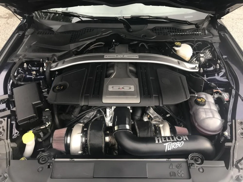

Hi:stage 1 whipple,eibach sportlines,advanti fury wheels,g force axels
