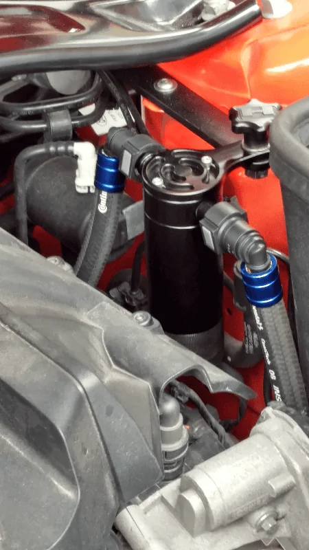

This is really dumb, but is it possible to install the single valve wrong? I've had this guy (http://www.uprproducts.com/mustang-b...tor-15-sc.html) installed for over a month and have had no return.
Can someone post a pic of their setup, including the arrows on the tubes? I'm worried :-\

Take a pic of yours and post it up. I have the DVCC myself, but if we have a pic of the way yours is set up, it should be easy enough to deduce whether or not it's correct.

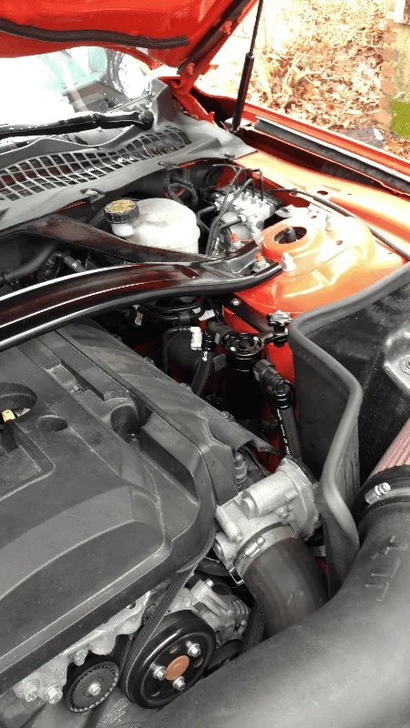

There are no arrows on the hoses or on the can but if you take the can off the hose from the PCV valve on the block should be hooked to the side that goes into the seperator and the hose to the intake manifold will be on the side that has direct access to the can.
Here is my setup.
