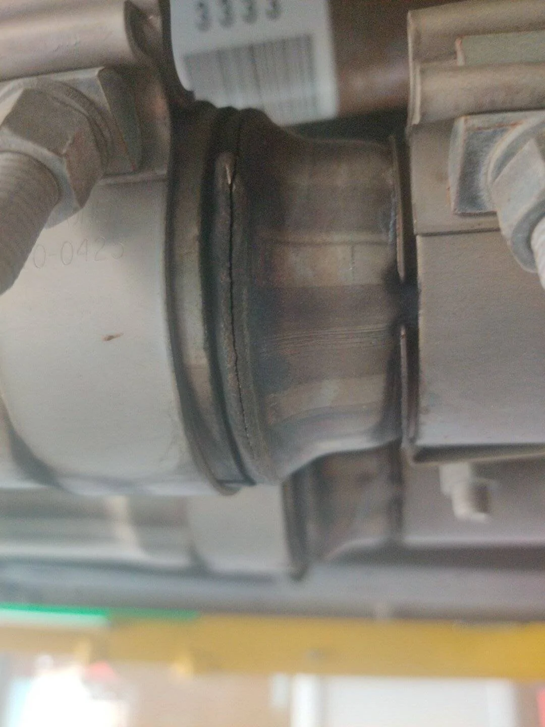

Update: finally got it on a lift and a nice crack as shown in picture on exhaust. It appears it is just at the very end of the stock pipes after the cats about 1 inch before the Corsa cat back starts. Any advice on options? The 1 exhaust shop I had it at advised he could weld the crack totally. Never had to repair an exhaust pipe so open to all advice and options. Thanks all

Well, if it's still the stock pipe with the factory cat, under the Emissions Warranty, they're warrantied 8yr/80k whichever comes first.
Since you modified your exhaust, I'm not sure if a Service Center will allow a replacement under warranty - tricky slope.... you can try and see if it can be warrantied out or not. My opinion is, if the upgrades exhaust is AFTER the factory cat, the Service Center should replace it under warranty because the upgraded exhaust component is after the cat. However, they may turn around and say the crack was caused by messing with the exhaust to install the upgraded components...
Other than trying the warranty route,, the suggestion by the muffler shop would be only other solution than replacing the cat itself.
