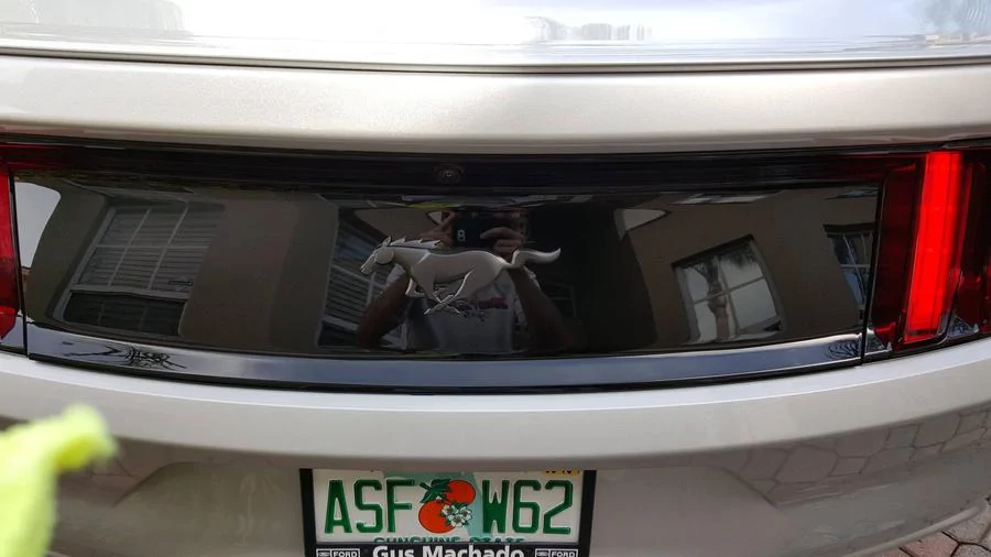

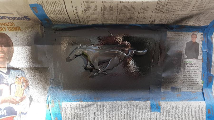

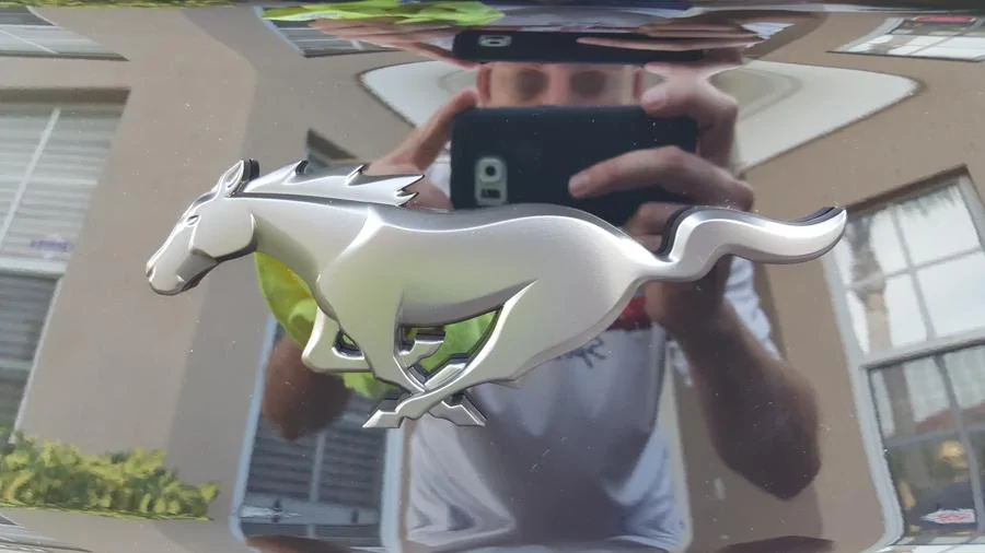

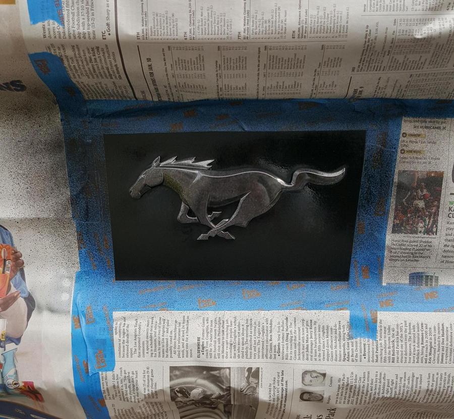

Yea as you can see I taped off a box around the emblem. I did like 4-5 coats, which allows me to peel off the surrounding quite easy.
As for the holes in the feet, i used 2 things, a pick and a long wooden shish kabob stick to cox and roll up the plastidip and remove it.
After first coat
A few coats in

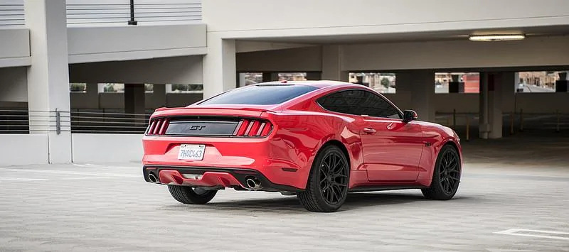

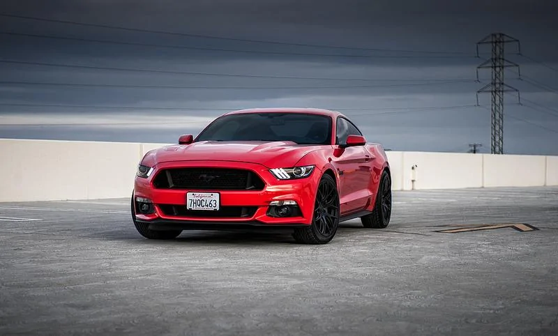

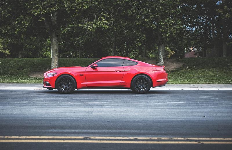

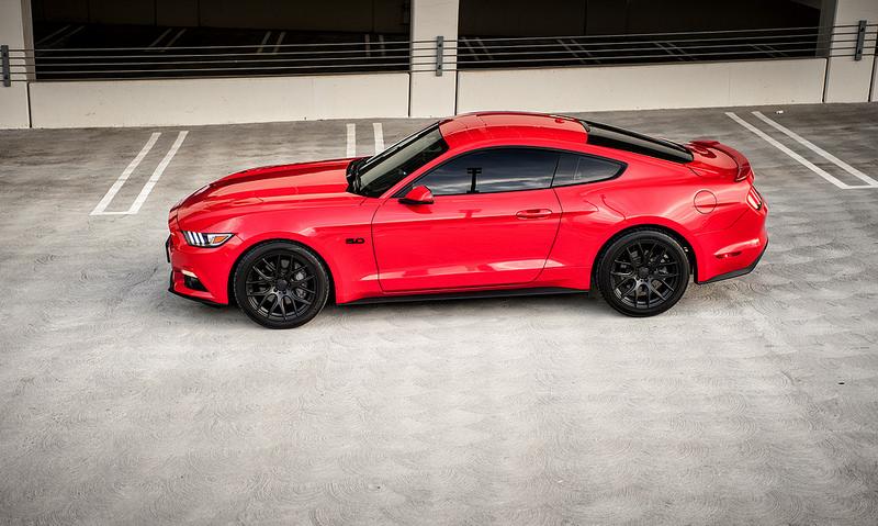

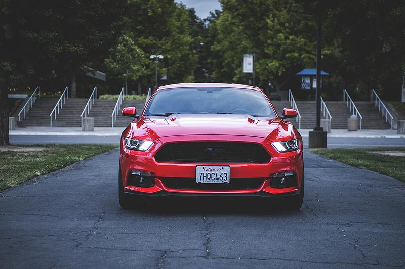

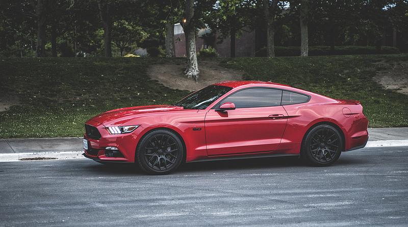

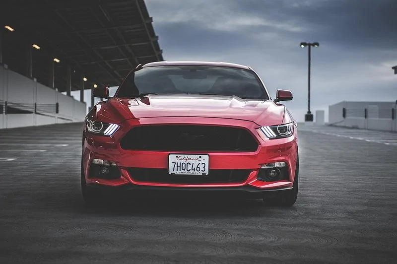

Alright, here's the results. dipped emblems and wheels
DSC_8466 by Max Denisevich, on Flickr
DSC_8528 by Max Denisevich, on Flickr
DSC_8543 by Max Denisevich, on Flickr
DSC_8595 by Max Denisevich, on Flickr
DSC_8606 by Max Denisevich, on Flickr
DSC_8507 by Max Denisevich, on Flickr
DSC_8488 by Max Denisevich, on Flickr
DSC_8512 by Max Denisevich, on Flickr
DSC_8614 by Max Denisevich, on Flickr
DSC_8556 by Max Denisevich, on Flickr
DSC_8539 by Max Denisevich, on Flickr
DSC_8572 by Max Denisevich, on Flickr
