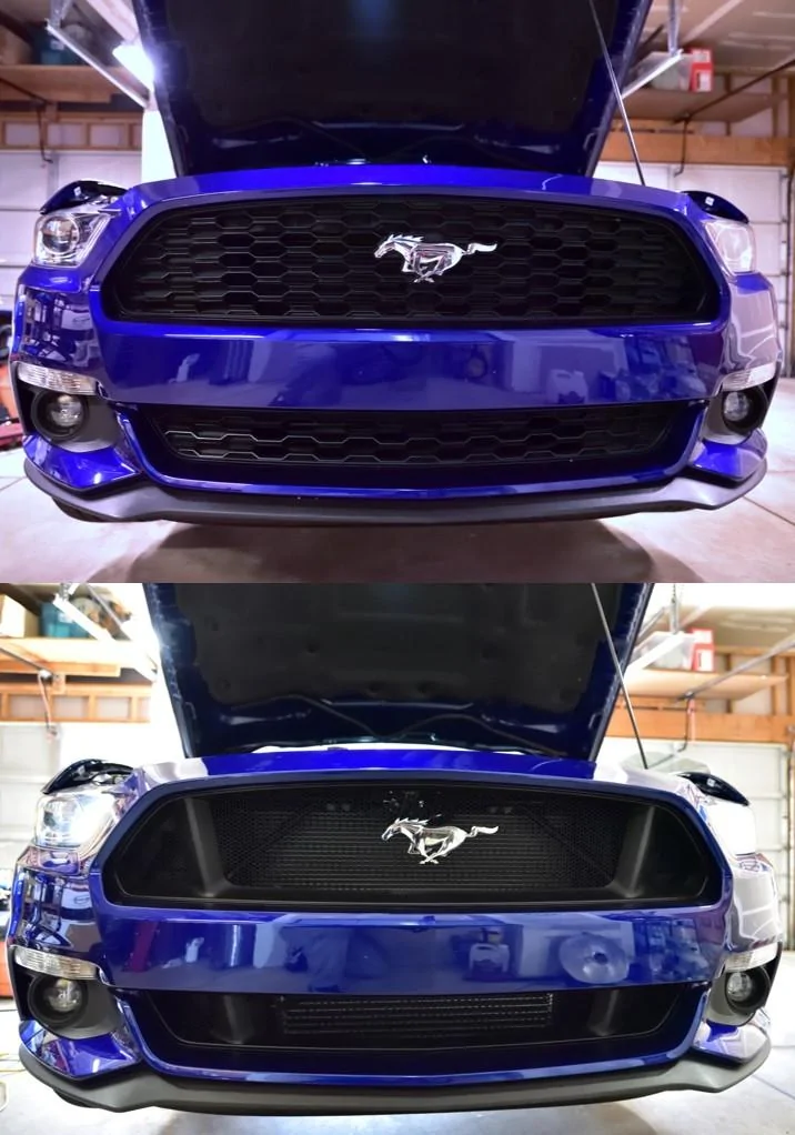

Wondering if hood pins would eliminate my bouncing hood after grill delete. Has anyone installed hood pins and eliminated the hood bouncing as a result? Obviously putting the original grill back in or getting a vented hood are fixes for this as well, but I'm aware of those options.

Let me see your grill.
