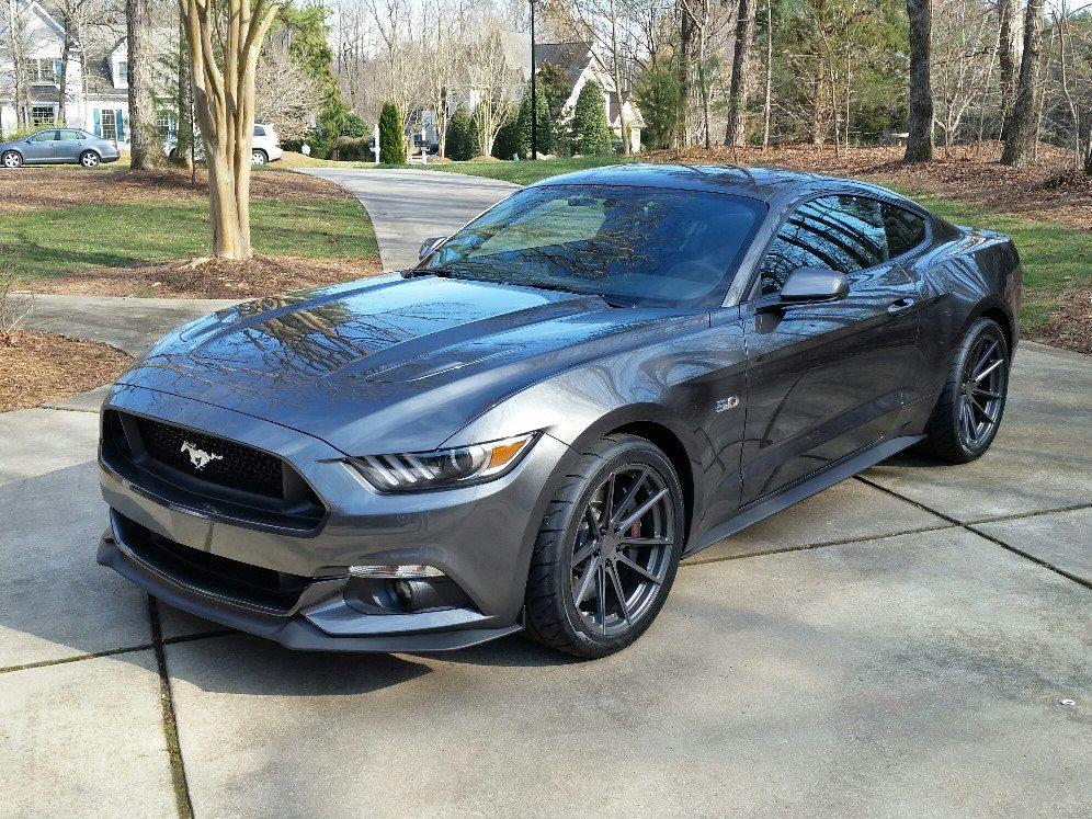

Does anyone have good pictures of an S550 sitting on 19x9.5 +39 wheel setup (squared). I've seen one picture of 19x9.5 R and 19x9 F, but haven't seen a square set up yet for 19" diameter wheels.
Any pictures would be appreciated and if anyone can confirm the +39 is a good offset for S550, that would be much appreciated.

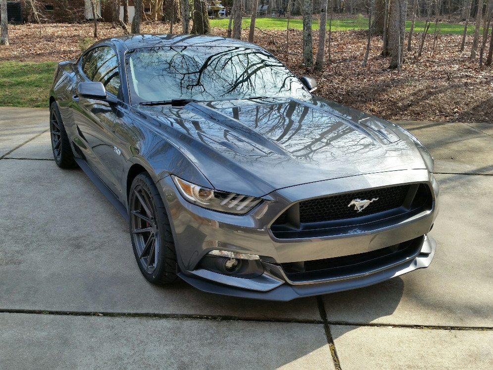

Here you go !
This was a setup we did for a client 19x9.5 ET 39 with 5 mm spacers upfront
285/35/19 RE71R tires all around
-ford-mustang-gtpp-s550-tsw-bathurst-gloss-gunmetal-rotory-forged-concave-wheels-285-re71r-tires.jpg

Here you go ! This was a setup we did for a client 19x9.5 ET 39 with 5 mm spacers upfront 285/35/19 RE71R tires all around
A 19"x9.5" +39mm has identical backspacing to a factory PP 19"x9" +45mm at 6.78", were the 5mm spacers just personal preference or are the 285s just wide enough to need the spacer to keep from rubbing on the front struts?

That looks fantastic.
Is that 19" x 9.5" + 39 front and rear?
I love that wheel design too, I wonder if there's somewhere in the UK I could source them?
I guess knowing what they are would help, and also if there are any other manufacturers (Judd, Vossen etc.) that do a similar wheel I could more easily buy :D
Its actually for caliper to back of spoke clearance sir.
Correct that is a 19x9.5 ET 39 all around
We ship to the UK easily
Vossen has the VFS2 model and a few other brands.
