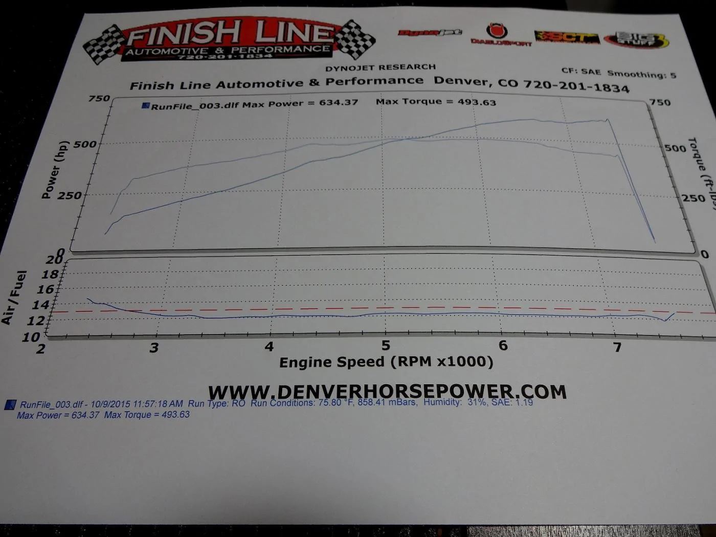

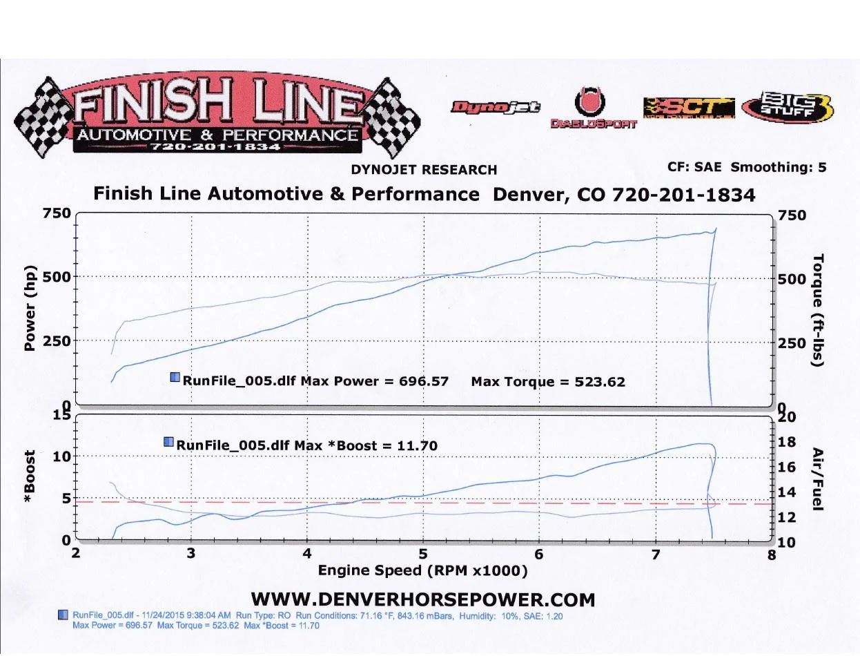

Here are the results using 91 octane fuel at 5400+ feel elevation
Both graphs are from the same dyno
AFR reading is a bit high. When logging the car's sensors are just above 11 at WOT.
The changes made are:
Gap: Was-.034 Now- .028
Intake: Was- Stock airbox w/ K&N Panel Now- JLT intake kit
Pulley: Was- 3.8 Now- 3.6
Tune: Was- Old\less fuel Now- New\more fuel
Second Photo is AFTER
BEFORE & AFTER
3.6 pulley/intake/Gap/Revision

Whats funny is that these numbers are very close to my Virtual dyno numbers when I input the correct data.
Uncorrect HP ranged from 570-580 on back to backs
AFR was measured at the end of the tailpipe.....To be honest, I dont think his tool was calibrated perfectly but who knows. The cars sensors read perfect AFRs at peak boost
All of this was done on a blend of king soopers 91 and diamond shamrock 91 (essentially your everyday average gasoline)
She's at 18-18.5 degs under peak boost & RPM
Elevation 5400-5500 ft, dry as bone humidity and a baro of 24.92-25 Hg
