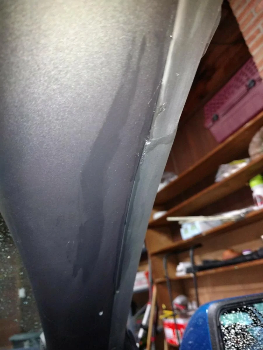

Passenger side window leak
Mr.Zergling
Jun 11, 2017
Seattle, WA
17 GT Premium Vert w/ PP
Anyone else had problems with water leaking in the top of the passenger side door? Didn't leak at all when I was washing the car but leaks quite badly while driving in the rain. Seems like the leak is at or just below this seam in the rubber (weatherstripping?) on the A-Pillar.

Yikes, nope, don't have that issue. I would definitely take it in. It is probably being forced in by the wind somewhere.
You could try taking the a pillar trim off, run a hose over the car while someone blows with a leaf blower. Look for source?
Fordever
Mar 6, 2016
83
2,568
1,309
NL, Canada
Derek
2016 GT/CS Convertible
Maybe your window needs adjusting???? My passenger window up too much. I noticed it with the top down, as the door and rear windows didn't line up. :doh:
Just a thought. Hope you find the issue:cheers:
