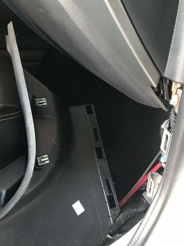

Is there anything special to remove the passenger side kick panel? I'm pulling out and away and I'm just getting flex out of it... I've removed the door sill trim and rear quarter trim but wanted to make sure there's not a bolt I'm missing or a trick to it before I break or bend something inadvertently.

No bolts. there are metal clips on the back and front of it. Its easier if you remove the trim piece along the side of the glove box. It also just snaps out. Im sure there are pictures or videos somewhere.

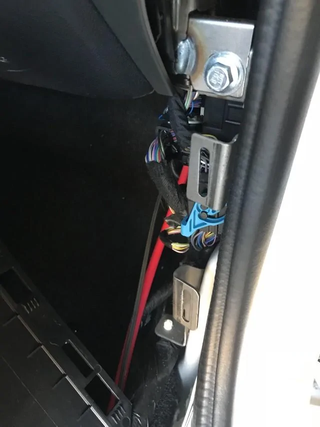

I couldn’t find videos or pictures online. It figured it out. Here’s what it looks like if anyone ever needs to search this topic down the road.
