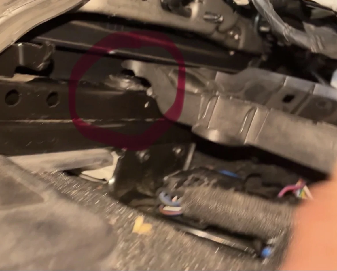

Hi everyone,
I've got a 2020 Bullitt and the passenger seat started acting up.
It will move forward a bit, but in an angle such that only the left side of it will start to go forward/backwards. I did not try to move it all the way to the front because I don't want to damage it. I'm almost certain that it's not the switch since, as I mentioned, the left track moves but the right side is stuck.
Any ideas?

Probably something stuck under the seat that has it bound up.

Crawled to check if this was the case and couldn’t see anything. But I found the issue - the plastic piece that bolts to the seat track broke (no idea how this happened) and a small rod that goes inside the track got out of place. I put it back in and done, seat works again.
