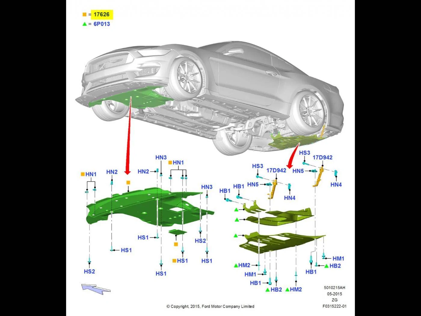

Pretty sure is this one.
W714312-S439

Only 2 bolts on the rear diffuser the rest are push clips. You have 2 different kind of push clips.
HB1 is the one you want correct?

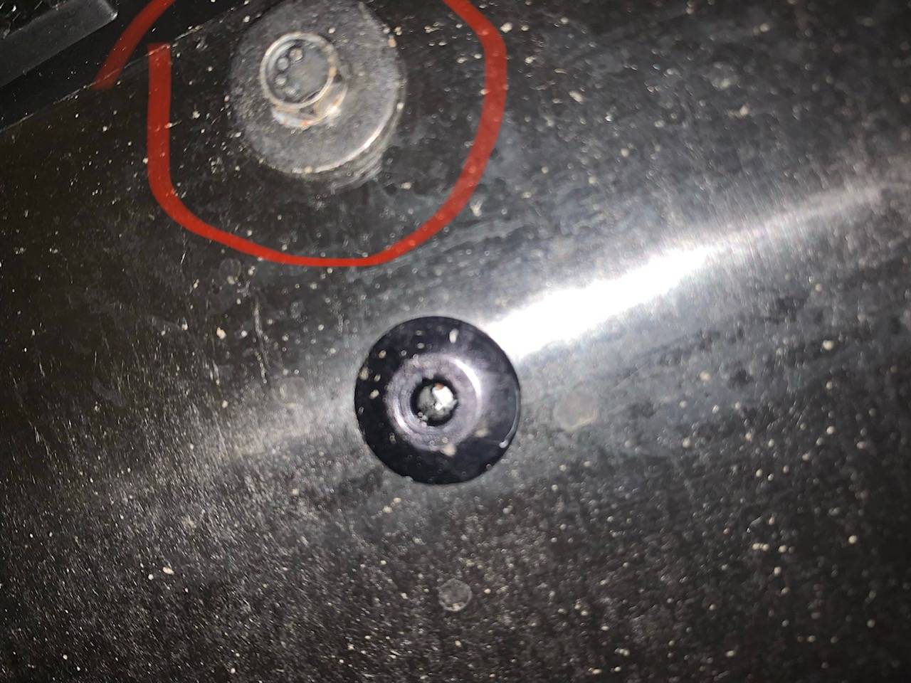

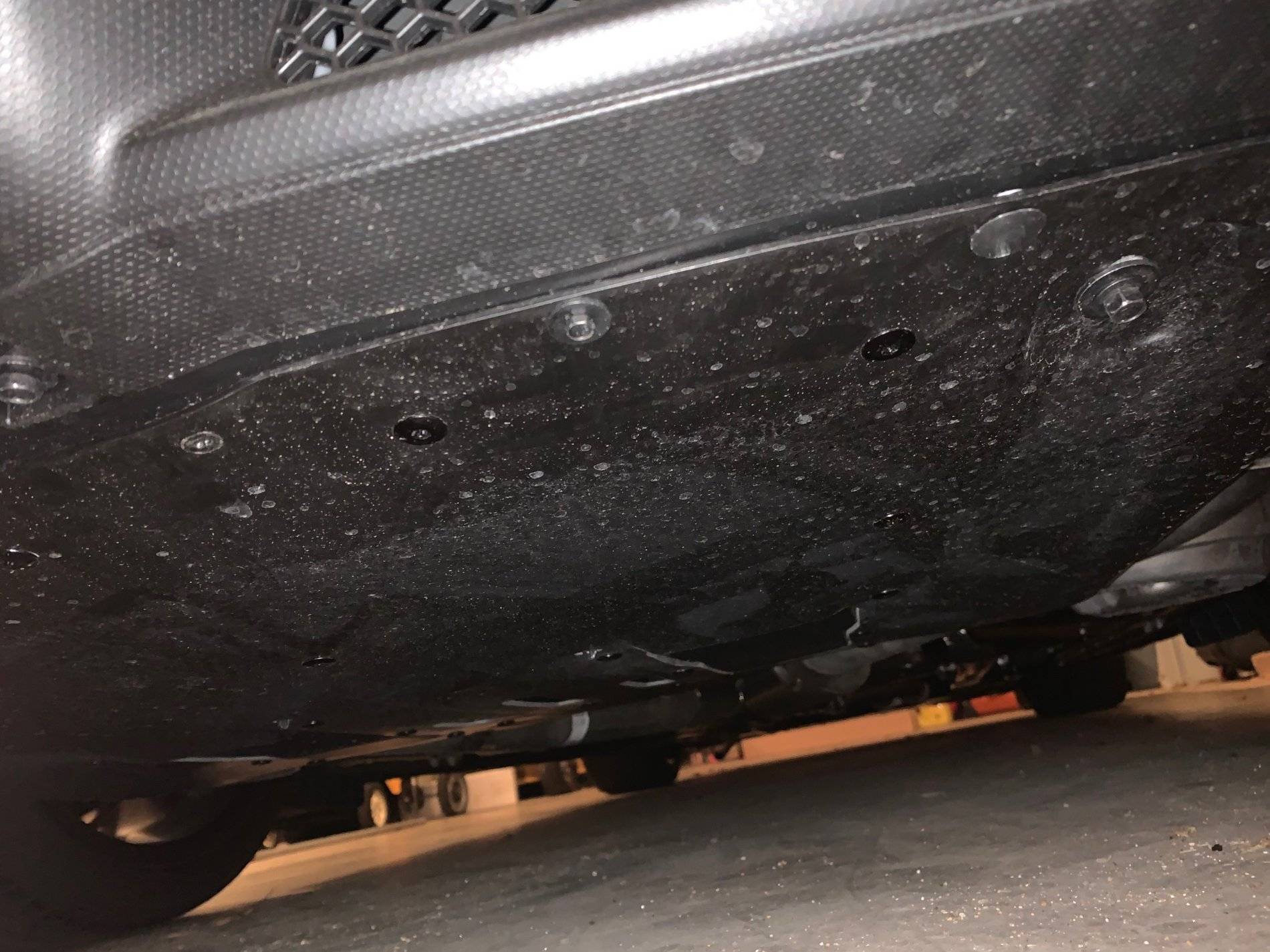

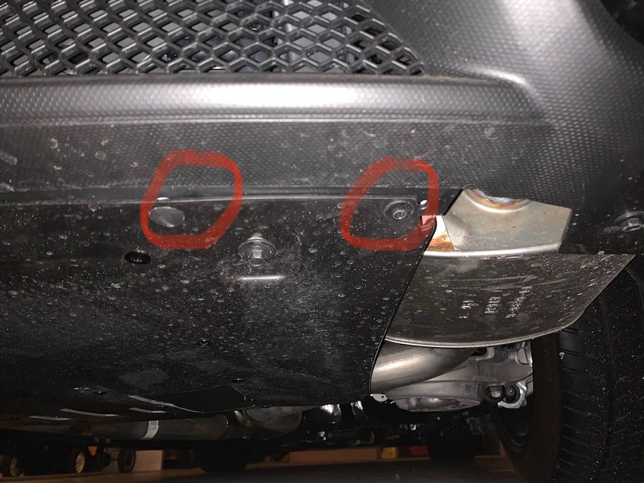

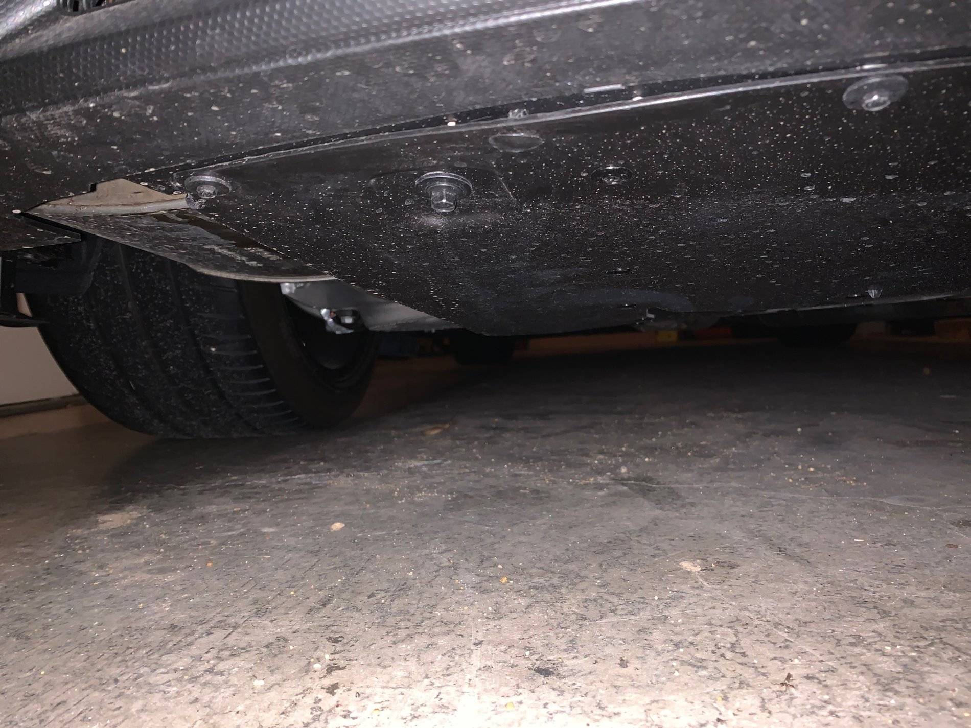

Thanks for the diagram, I couldn't find one. However, what I have seems to differ then what you're stating and what I can discern from the picture...not sure if Ford changed or the dealer did something. My area of interest is the fasteners along the rear edge closest to the bumper...there's a total of 9 in a row. It appears if starting from left to right it goes screw, pushpin, screw, pushpin...etc. If that's the case, I would need the pushpin numbers. If I can get both the screw (circled in red) and pushpin (circled in red as well) part numbers, that would be great.
And sorry for the dirtiness of the car, it rained on my way home from pickup and haven't had a chace to clean her up..plus flash makes it look worse :)

  • 1 x FR3Z-6P013-D Panel
  • 4 x W712977-S439 Bolt
  • 1 x FR3Z-17D943-C Bracket
  • 1 x FR3Z-17D942-C Bracket
  • 2 x W714312-S439 Bolt
  • 2 x W520812-S439 Nut
  • 2 x W709990-S439 Nut
  • 8 x W714040-S300 Clip
Here are the list of all the parts that are used.
