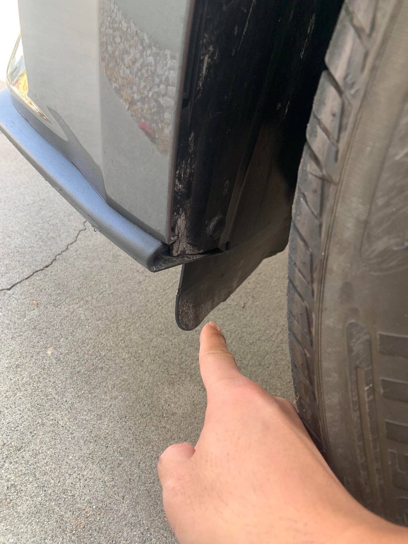

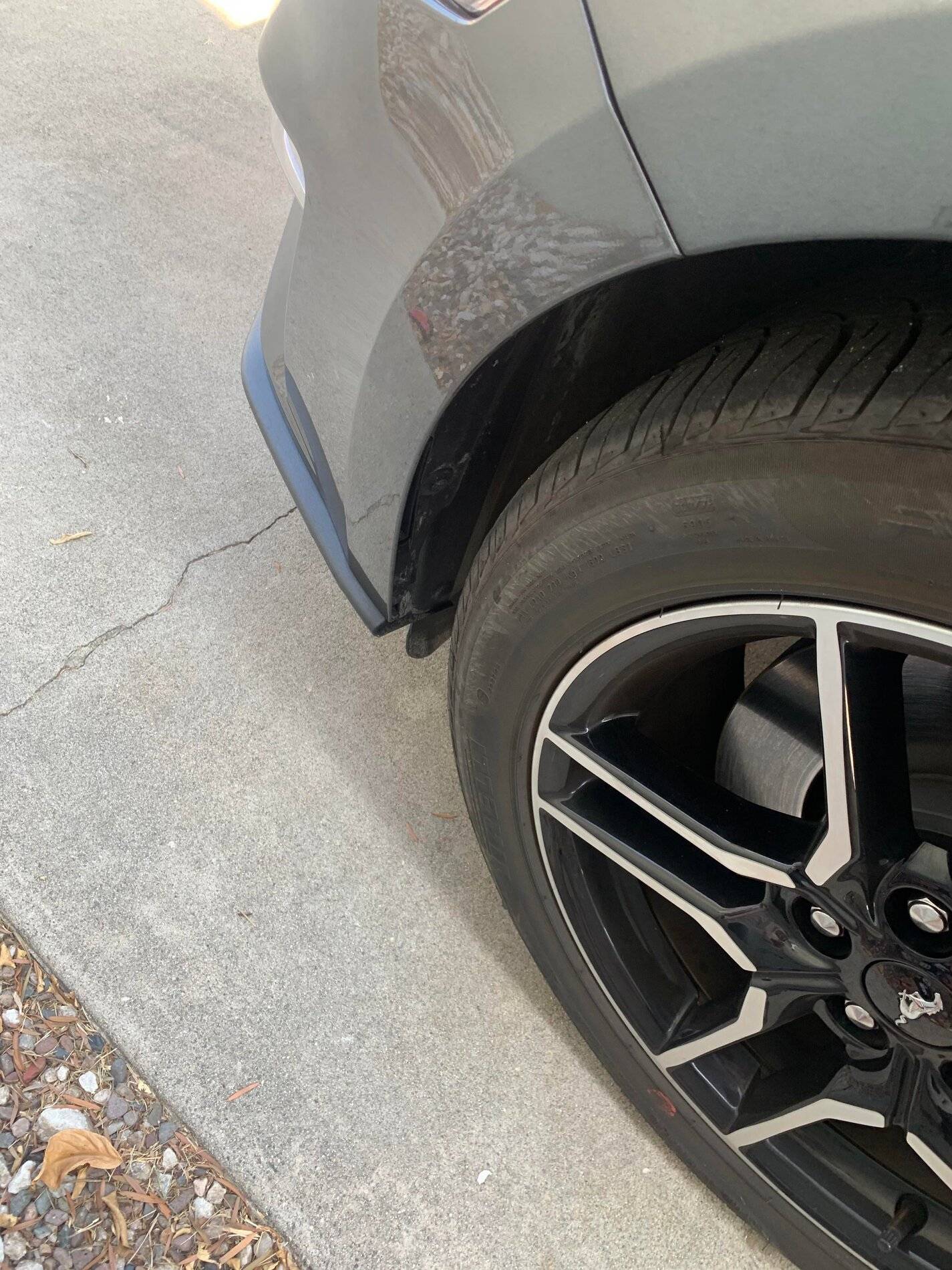

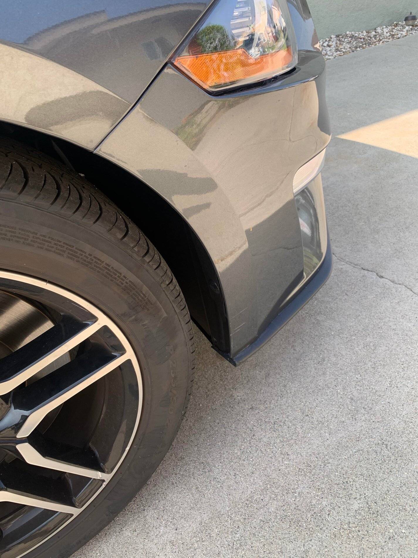

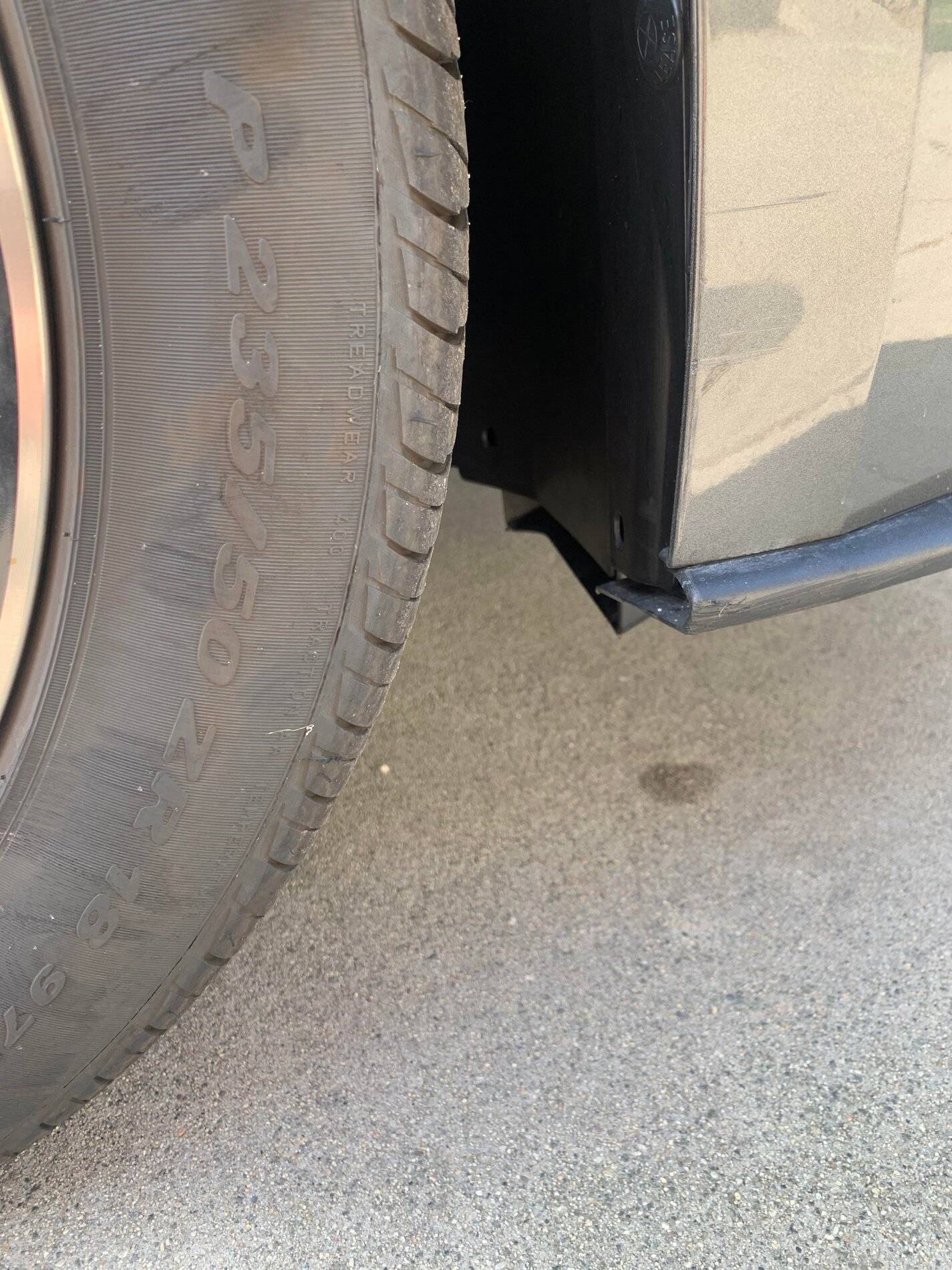

Hello everyone,
I recently found out that my mustang is missing a front left wind flap? I have searched American Muscle and other sites but couldnt find a replacement part.
does anyone know the part number for the piece? just the rubber flap. or does anyone has one for sale?
Thanks guys!

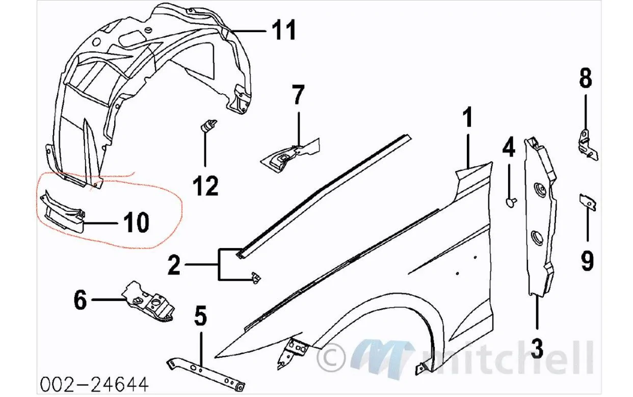

Dec 21, 2019
381
471
Jim
2019 Mustang GT Premium PP1 401A
Shield, Splash
EcoBoost, EcoBoost Premium Model
w/Performance Pkg18-19 RJR3Z 16102 D0.00
LJR3Z 16103 D0.00
w/o Performance PkgRJR3Z 16102 D0.00
LJR3Z 16103 D0.00
GT Model
LJR3Z 16103 D0.00
GT Premium Model
LJR3Z 16103 D0.00
W.O.T. Stang
Dec 21, 2019
381
471
Jim
Should be #10. But it’s difficult to tell. You can always swing by your Ford dealer. The parts guys there can definitely confirm it for you by VIN.
