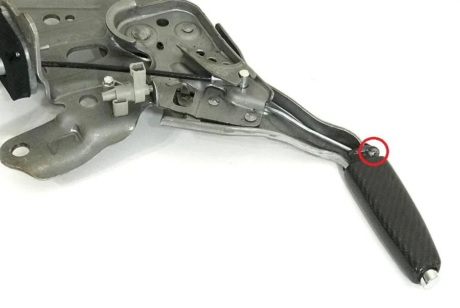

Tab?
Which Part? I haven’t pulled the Boot off yet.

Chicago suburbs
Supercharged 17 GT Premium, Performance Pack
circled it here. kinda hard to see from that angle but you'll see it when you remove the boot.

If you look at the circled part in the pic above you can kind of see a small tab that is part of the entire metal handle. The handle cover goes over the tab and clicks in. Not difficult to get a new cover on bit a real PITA to get off. I ended up making a small cut in the cover to get it over the metal tab. handle cover stays on fine even with that done.
