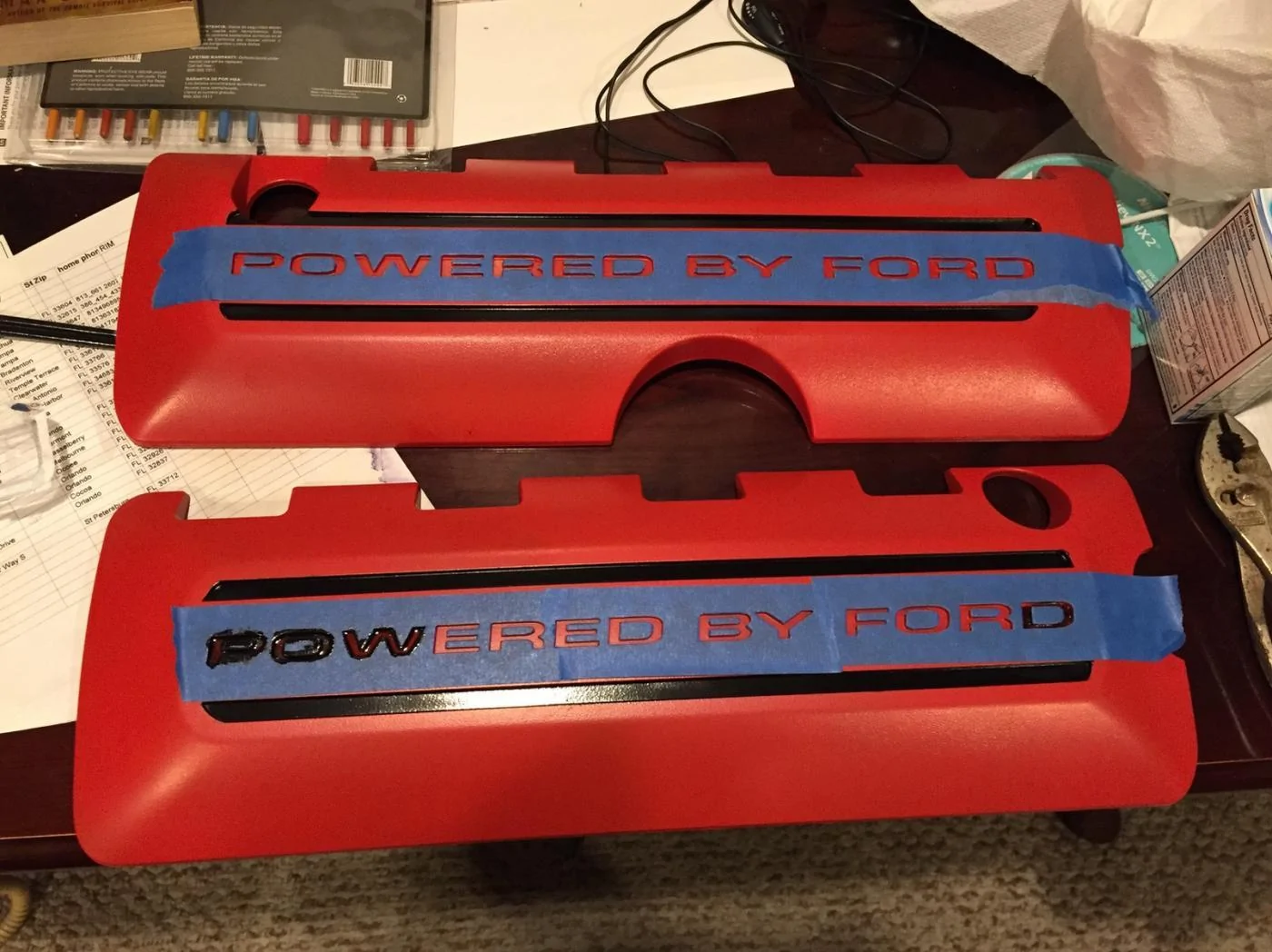

after you paint the covers. then put on clear at the letters... then spray the letters and take model airbrush thinner and wipe away excess over spray off that clear immediately.
There are a few vids on YouTube that show the process, but the previous post covers it. Paint base color, spray on clear. Mask off everything, expose letters a couple at a time and spray. Wipe off overspray with airbrush thinner. I am going to do it this weekend and will document my steps. I MAY try brushing the letters rather than the spray/wipe, if I can find a brush the exact width of the lettering.
I used spray bomb engine paint. Did lots of prep with smoothing out the pebble grain finish. Sanded off as much as I could, the built up lots of sandable primer from a can. Then sanded smooth. Took about 4-6 rinse and repeats to get it smooth.
Since the letters were recesses, I simply used an eye dropper to drip in black model paint to fill it in.

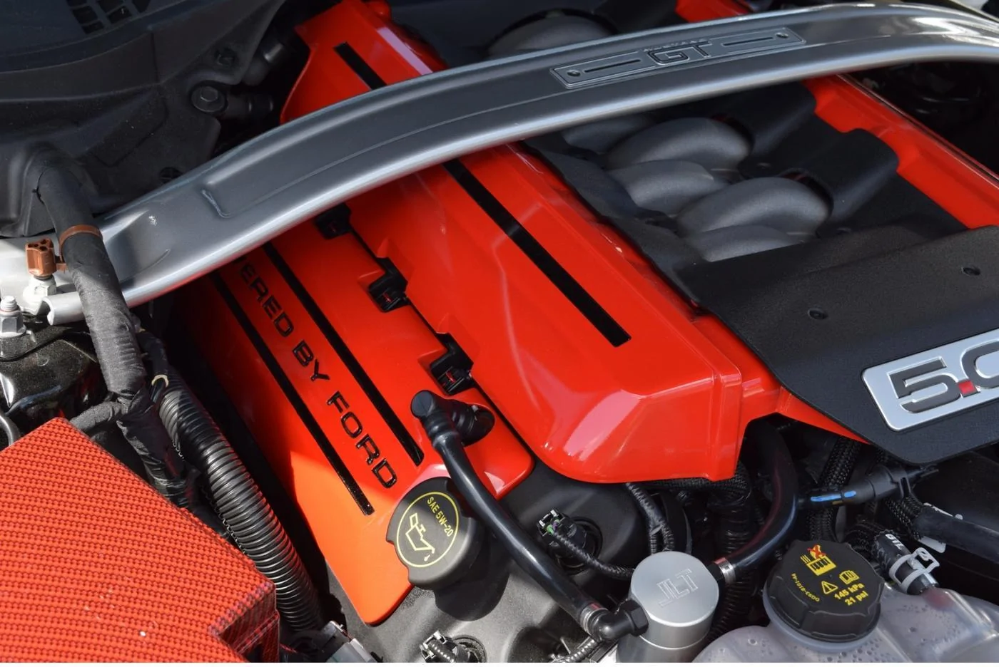

For paint, I bought Dupli-Color engine paint. I am going with red lettering and line, dark gray for valve covers and most of the engine cover. Black for the center of the engine cover. I also have primer and prep materials from Dupli-Color. Take a look on their web site for colors and heat. Nice selection. Their paints have never failed for me.
Great tip on the eye dropper technique. For the lettering, most people say to finish the valve covers with the main color, then cover it up except for a couple letters at a time, sprat lightly and then wipe the mail part of the valve cover immediately with a rag with a light coating of rubbing alcohol, I think.
