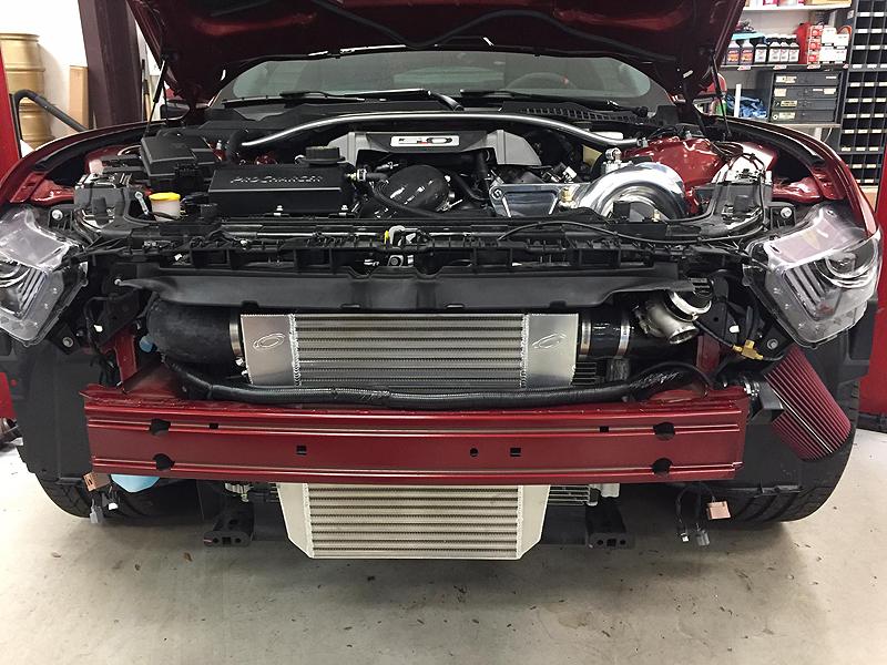

So now that I have had the PC on for a full year I am going back to correct a couple of issues that I need to fix. Toward the end of my install I started hurrying a bit because I couldn't wait to drive a boosted coyote...nothing major but still annoying.
One of them is that since installing the stage 2 my outside air reference skyrockets if the car is not moving. I am assuming it is by the intercooler somewhere and relocating it will solve the issue. I attached a pic ( another members car ) that has a good view of the front fascia off with the Stage 2 IC. Can someone point me to where the sensor might be?

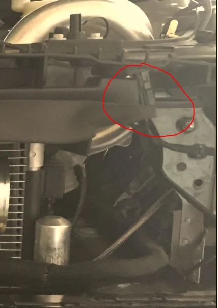

i ended up modifying and rotating as it was close to my wastegate. I zoomed in so if you want me to back it out and circle i can.

Hey man i did not pay attention on my 2015,but the previous years they were in the front bumper cover either near the grille or near the drivers side.

Yep bet its probably your wastegate effecting it after looking at your pic with your cover off.

I went in and adjusted my blowoff tubing to fit better, and saw what I believe was the ambient sensor. It was on the underside of the bumper to the left (passenger side) of the intercooler. It nearly touches the intercooler.
