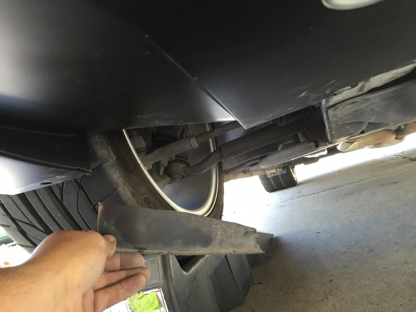

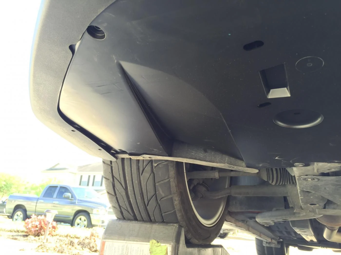

Pretty sure the Ford part number for the PP belly pan as we call it, or Stone Deflector, as Ford names it, is FR3Z17626D. Quicksilver, if you buy the PP part referred to here, you will need to do three things: 1) trim the wheel well liners to get air flow as intended, 2) throw away the soft rubber "curb feeler" from your stock set up because it won't go with the new parts, and 3) drill some holes in the back middle of the new Stone Deflector for you to screw it to an existing plastic cover. If you don't do this last thing, it will be loose at that point.
