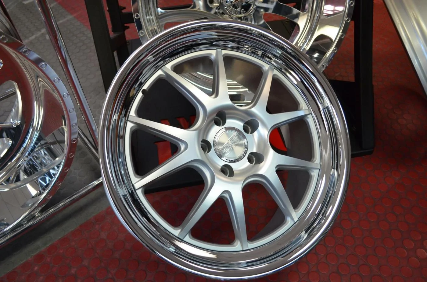

THANK YOU SO MUCH for not giving into the concave revolution. SHINY LIPPED WHEELS FOR LIFE.
I dont have a problem with the concave stuff as long as its not too much but finding just a nice polished rim now is near impossible. All painted silver or black.

Thats the beauty of wheels they touch every style.
I used to have a badass big lipped square setup, now I rock concave, now I want a lipped concave wheel like the Ferrada wheels.

I've been on the hunt wheels for a full year the one thing I like about these is that they look like the forgeline ga3 but without the price tag lol

They do look similar to GA3's. I know, had them on my CTS-V Coupe. Nice choice.

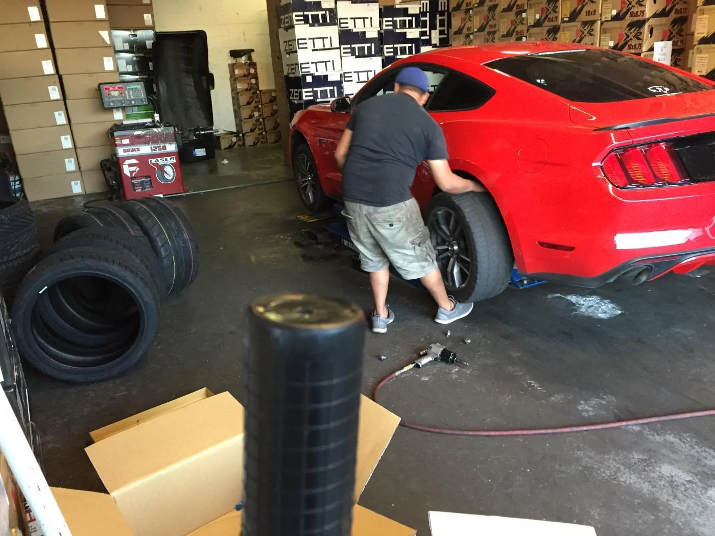

Until I can get a nice photoshoot pic enjoy this one :ford: i love it I did ran into some troubles.... According to some websites ,These do fit the non pp 2015s the fronts 19x9 +36 fit perfect but the rear 19x10.5 +42 offset needed a gasket size spacer about 3mm I believe I'll get the exact measurement tomorrow and because of the lip the air stem is inside of the spokes so it needs a bent stem that comes outward in order for it not hit the caliper I'll post all this info with pics tomorrow for everyone to see

Also the wheel weights are not that bad for the price I got
Front 27.8
Rear 28.0
